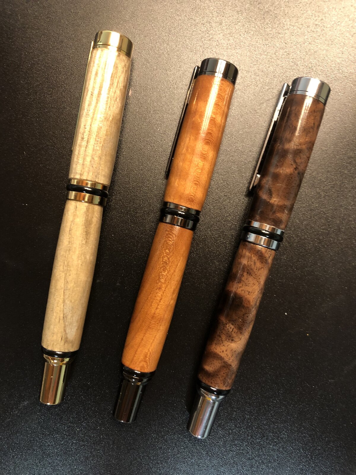

Finished my first (walnut burl) second (cherry) and third (red oak) pens for the trifecta of cigars. (sorry, they're right to left). Updates that you didn't need but that come from someone finally feeling like they have some sort of "hang of it".
