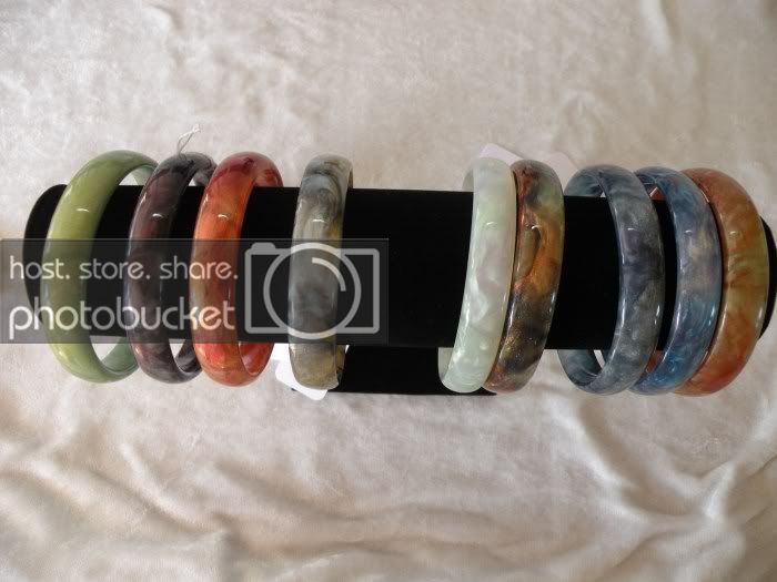

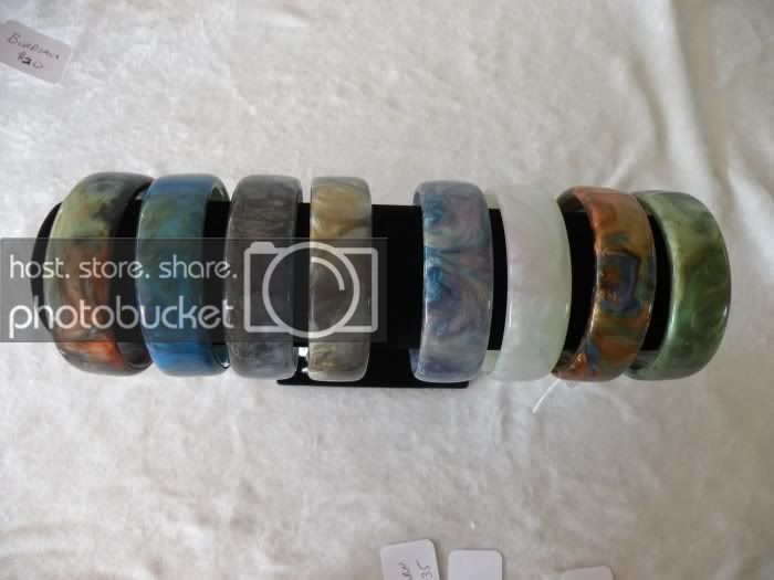

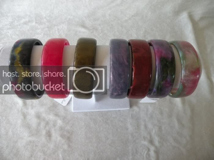

Hey, Gang. After finally getting the materials to make a mold for these, I was able to cast and turn my first PR bracelets. Let me know what you think.

Thanks for the comments. I have dropped these with varying results. They don't always shatter, but you know how this stuff can be. The Beall wheel grabbed one out of my hand and threw it across the room with no damage at all, but I wouldn't call that a test. Alumilite might be my next effort with these as we've learned that it is less likely to shatter, so I'll let you know when I try that.
I have not done a tutorial yet as these are my first efforts, but I will do one if there is real interest.
