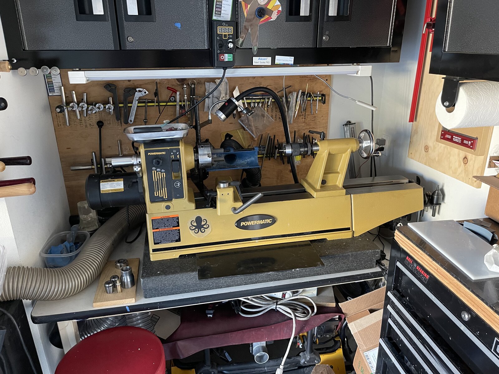

Side note, I know you did not ask: really love the bed extension for getting things out of the way and for making longer handles. Also the head can also slide left and right.
Also Rick made me a custom adapter so I could use my old pen making tool posts (5/8) with the new PM2014, PDF DRAWING INCLUDED.
