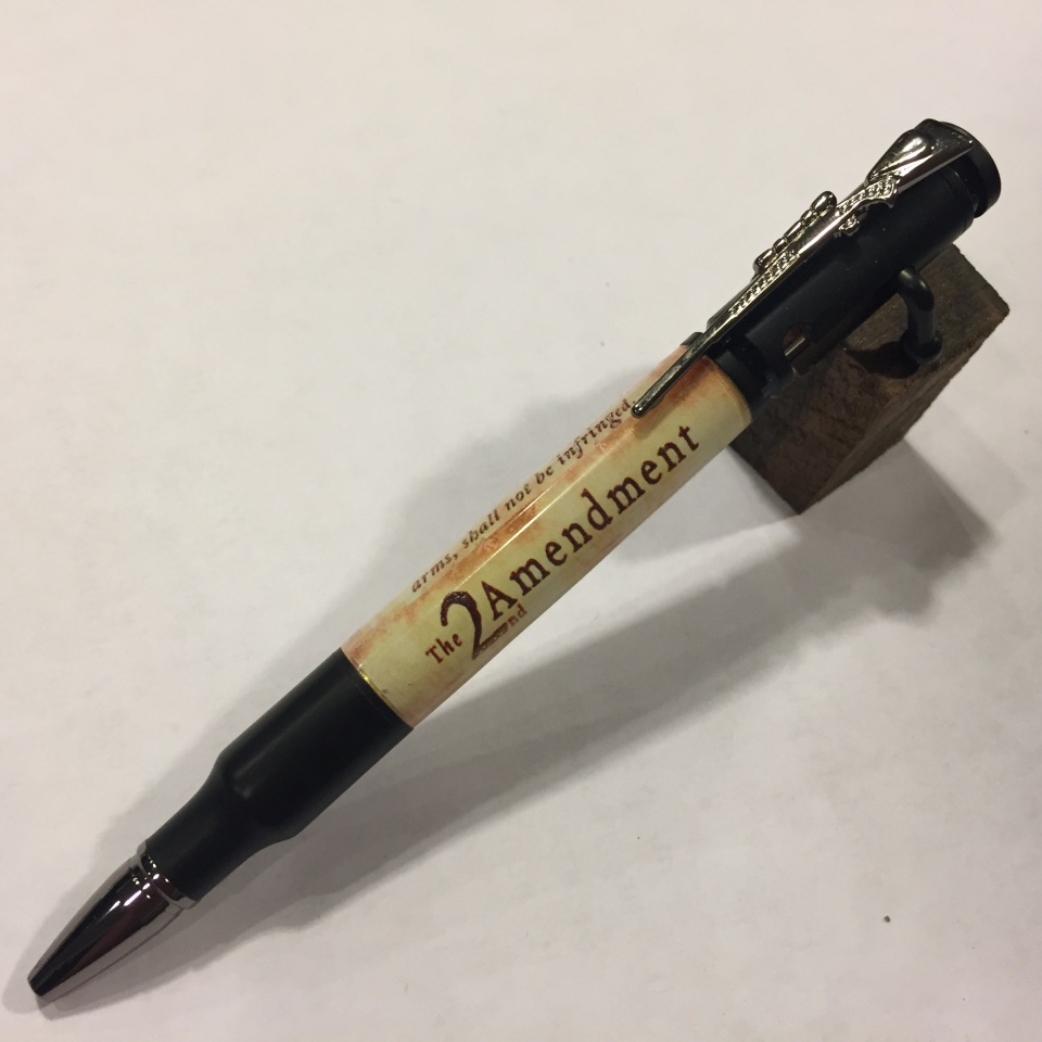

Was finally able to get in the shop last night and turn out a few pens! Talk about therapeutic! I had cast the 2nd Amendment label blank a few weeks back and have been itching to put it on the lathe. Mated it with a flat black .30cal bolt action kit and I am really liking the results! This was my first successful label cast after many failed attempts so I am ready to try a few more now! This pen sold so fast too!

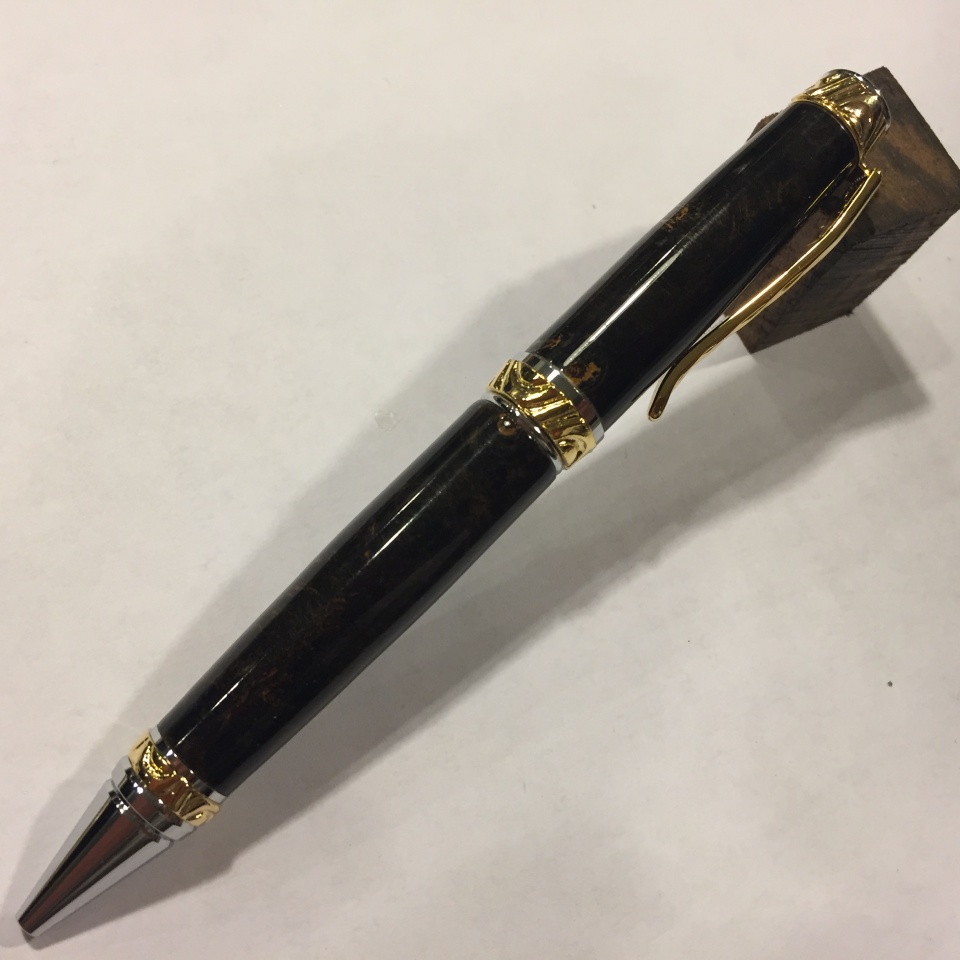

The second pen is part of the inventory I am building up for my first craft fair. It is a black and gold double dyed burl on a Berea gold and chrome Ultra Cigar Pen kit. 10 coats of thin CA sanded through 12,000 grit and hit with Novus 3 then Meguiar's Plast-X, and then Novus 1 polishing compounds.

Great looking pens.
