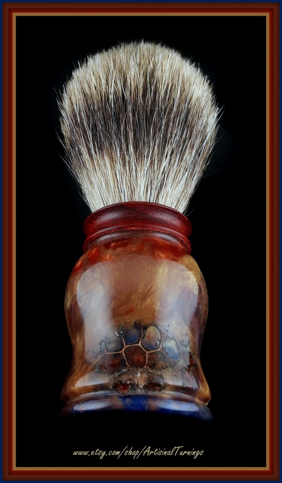

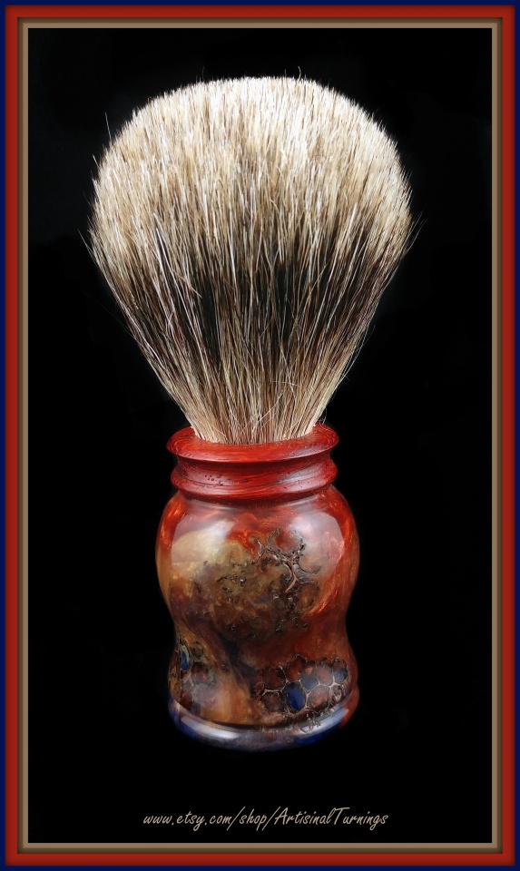

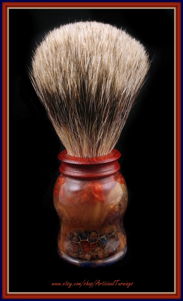

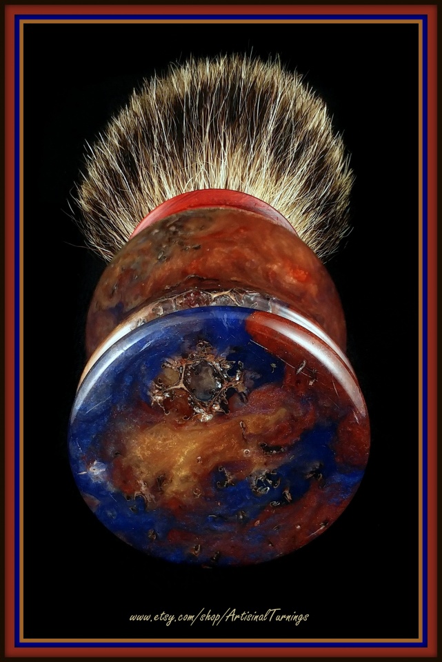

I was curious about using pottery glaze pigments to color polyester resin, so I decided to experiment and cast another shaving brush handle using three pigments: iron oxide (reddish orange), titanium (yellow) and mazerine (blue). I also threw in some sweet gum pods. Rather than use a metal collar I decided to turn one from Padaulk since it appeared to match the reds in the resin. I also added a bit of Pearlex which matched the pigment in each cup. I think the experiment was a success. What do you think?
