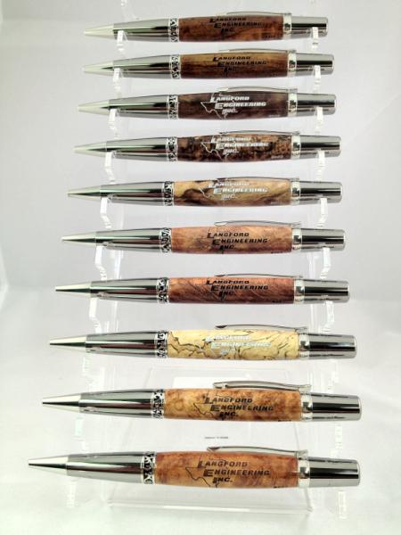

Well, it's done.
Made final delivery of the pens today. Both the bosses are happy. They handed out a few last night at a client meeting and the clients were pleased also.
I also made a special pen for the pres. and VP of the company as a "thank you" for the order and for entrusting me to uphold the company's image with our clients.
and now for a few IAP thank yous that I need to send out (in no particular order):
MsequiteMan for selling me the ugliest (yea, right) blanks I've ever seen. I think he raided his personal stash...and thanks for prodding me to try turning them between centers. Works like a charm!
mrcook4570 (Stan Cook @ happyturners.com) - for all the laser work
GerberMike - he's a new member here that I've known for a few years off the forum. He came by one day and without my asking...set up my disk sander for blank-squaring and helped rough turned a bunch of pen blanks.
rherrell set me up a some new tool rests for my Jet mini and a sanding mill
and johnnycnc got my TBC needs taken care of with new bushings and drive center.
and everyone else - thanks for your words of encouragement and tips posted here and by PM's for "production mode" turning.
Now I need a break!
Here's 10.
I'm not pulling them all out of their boxes for photos. :)
