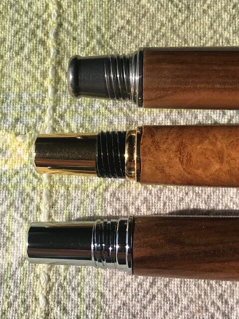

montmill
Jan 26, 2008
644
13528 Old Hwy. G Montfort, Wisconsin
The treads make a different too I think. The bottom is a new Junior Gent, the middle an older Junior Gent and the top one a Desire from McKinsey Pen Works. They range in difficulty from bottom to top with the bottom being the most difficult. Look at the thread count and machining of the threads. Don't you think that makes a difference?
ed4copies
Local Chapter Manager
Mar 25, 2005
24,528
Racine, WI, USA.
As I understand it, from doing fountain pen shows, the purpose of the threading is to make it easy to post the cap.
Many define "easy" as one full turn at a maximum. So, the pen community resorted to wide threads.
