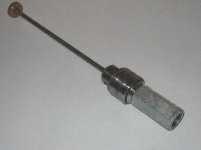

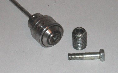

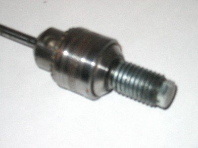

When I first started turning pens and had only the HF lathe, I made an adaptor from a rod coupler and a piece of 3/4" threaded rod. I used a chuck from a hand drill that no longer worked. You can buy a chuck with 3/8" internal thread in most hardware stores. This is how I made the adapter:
1. I cut a 1-1/4" piece of threaded rod. In the metal lathe, I drilled a 3/8" through hole. A machinist would call this hole a "slip fit" which means there is virtually no slop. Then in the same metal lathe, I faced each end true, to make the piece of rod 1-1/8" long.
<br />
2. I bought a 1-1/2" long 3/8-24 bolt, that is a fine thread (NF). These bolts are measured without the head, so the whole bolt is a little longer. I threaded the bolt through the threaded rod, and screwed it into the chuck.
<br />
3. Then I threaded the coupler onto the rod.
<br />
This was done about 3 years ago, before I bought my Jet Mini. Maybe I was lucky, but it worked for me. Hope this helps ....
