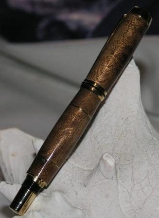

Started out turned pen with whatever style you like.
Sanded upto about 600 grit.
At this point I took the Plexi solution that I had. The solution was about as thick as syrup to start. I tried the solution like this and did not work so I thinned this down to about a little thicker than thin CA. The solution was mixed in a squeeze bottle that came from sally's beauty supply.
With the lathe running at about 1800 rpm's I started applying the solution with the bottle and a folded paper towel. The first attempt I tried about 5 coats but during sanding sanded it all off. I settled on 10 coats. This seems like alot but remember that this a thin solution. This whole process took about 5-10 minutes tops. Very impressed with the drying time with this stuff seemed as though it was about the same as the thin CA.
After I built up what I felt was enough material I then started wet sanding at 1000 grit wet dry for a brief amount of time then moved all the way up through MM grits.
The finishing steps were to use a scratch removing compound. I used some stuff from Wally World GS-27 followed by Meguires car wax.
While I'm not trying to take away from Fangars finishing technique it comes with a steep learning curve. This finish seems to be fairly simple. The toughest part about it is finding the right consistency for the solution. I dont know how the finish will hold up over time. I would think that it should hold up fairly well do to the fact that it is plastic. If there are any questions I will try my best to answer them for you. Please feel free to experiment with this and keep everyone updated. Russ Fairfield said that he uses a similiar technique only he uses BLO to smooth it out while still wet.
This a photo of the finish on the first pen tried:
Hi Terry, great looking finish! I think your a really on to something. Were do you get this Plexiglas stuff? I have always stabalized my blanks with CA glue. I am always trying new stuff so would be interested in this finish and your tutorial. I do a lot of inlaying so I need a finish that is durable and long lasting.
Janet
Janet I make the solution. It is Plexiglas (Acrylic) dissolved in acetone. I made a big batch a while back keep it in a gallon paint can. I took some of this syrup consistency and thinned it with more acetone in a bottle for use.
That is all that is needed I covered the bottom of a new 1 gallon paint can with Plexiglass about 2" thick then filled with acetone for the thick solution. After that is made you can thin as needed.

Janet no PR and Acrylic are not the same the source that I use is Plexiglass which is used a lot as safety windows. You may be able to get scraps from a glass dealer from where they cut it to size for the window. The scraps or even the shavings would work.
Good idea !!! I have used acrylic finishes in the past; they shine line glass and are very durable. The sanding technique you described is exactly what I used.
Best results with a commercial product have been with Krylon Triple Thick Crystal Clear Glaze, from WallyWorld. I transfer the barrels to a wood dowel and give it 3 coats off the lathe, letting dry in between. Then back to the lathe to sand and polish as described above.
Terry,
I have tried this on two pens so far and it seems to work REAL well.
Like you I sand up thru 400, clean with DNA then seal with sanding sealer. Using my thin mix, 5 - 6 coats then up thru the MM (if I did a good job of getting smooth coats.
I believe this will become my finish of choice. Takes a bit longer then the Shalack and should last a LOT longer then the PPP.
Thanks for the idea.
