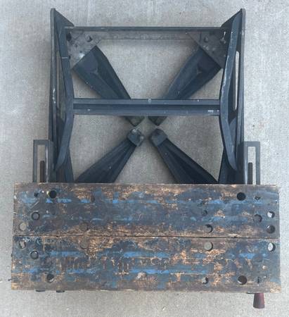

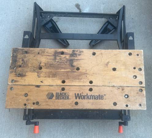

There's several near you. Here's one:
Might not be the same model but it doesn't look like the flimsy one.
This one is begging to be refurbished.
