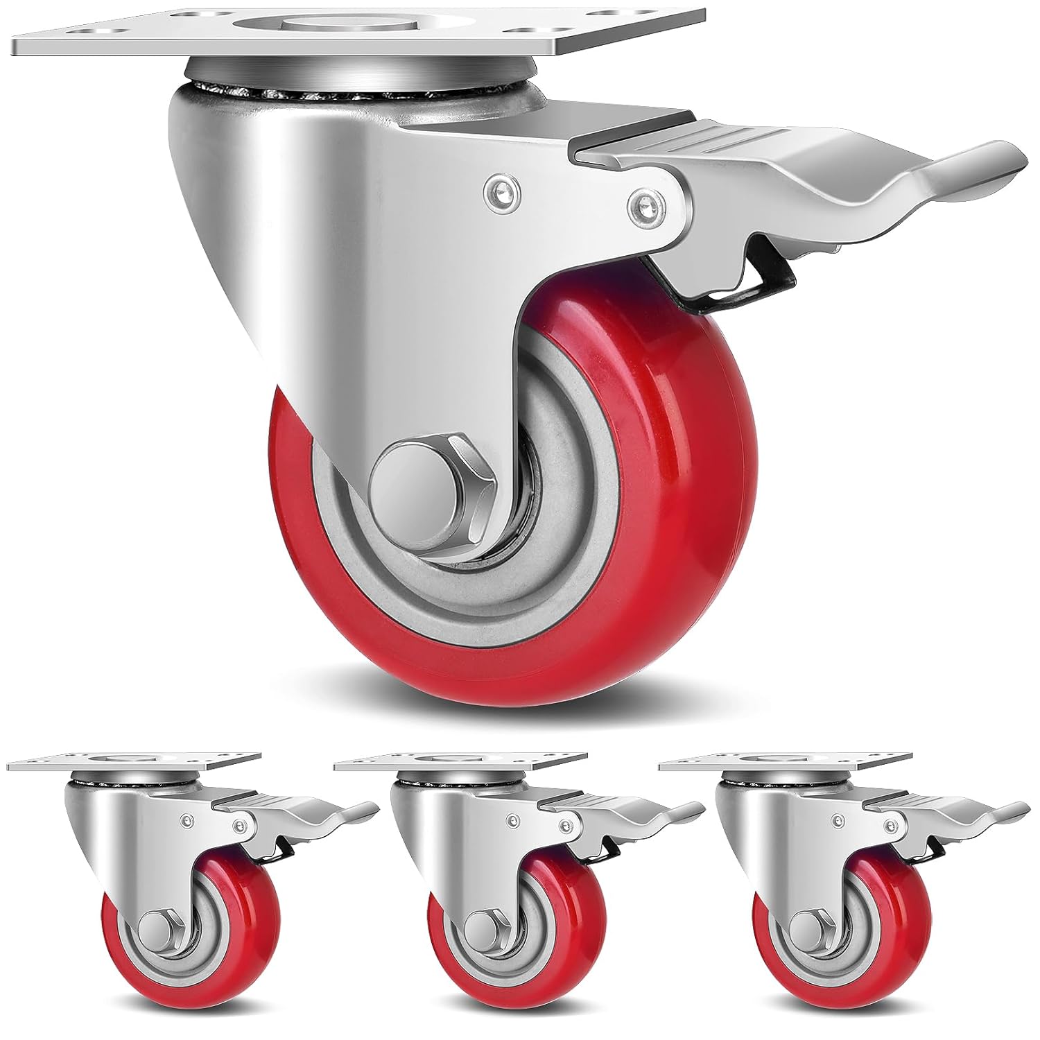

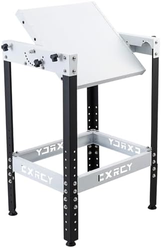

This past winter I had mentioned here that I did some modifications to my shop to make more accessible and safer. One thing I did do was buy one of these flip tables to support 2 bench tools. One is my Tormek sharpening station and the other is a bench top combo disc belt sander. I put those wheels on a couple of my tools and it made a big difference. Those roll so smooth and move in any direction and all lock. Glad I made this improvement. I can move these tools around anywhere I like with ease. May want to look into flip top tables. I bought all off Amazon.

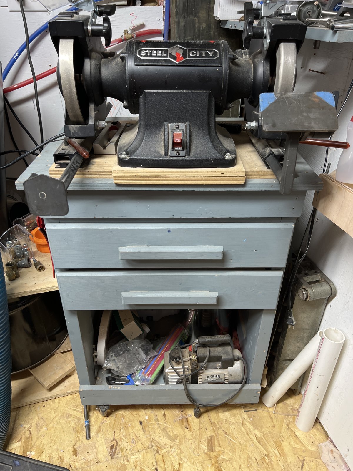

I put one of my grinders on a pedestal stand from HF and I can tell you I am not recommending pedestals unless you can anchor it securely to the floor. The HF does the job, but it's a bit tippy. One good thing is that I haul it back and forth between my shop and to club sharpening demo's, which is handy. My main shop grinder is on a home made wooden rolling stand with draws that I like better.
Also has storage underneath for my stabilization stuff.
