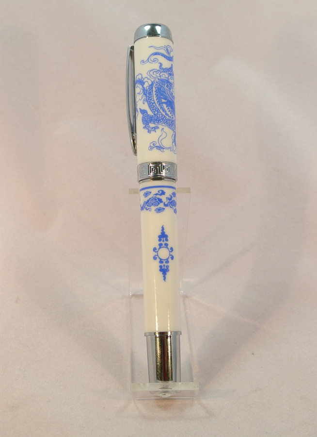

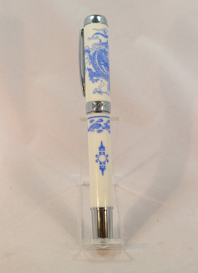

I have one picked it up at Goodwill. Jinhoa makes some. For the money, they aren't that bad. They actually have decent reputation for the price for the fountain pens. Will it compare with a nice one? No, but many of the nibs we use cost more than the whole pen (in a box!): Amazon.com: Luxury Fountain Pen Jinhao 950 Blue and White Porcelain Dragon Medium Nib 18kgp: Office Products
Pics of mine are attached. So I don't get the ever present, "pics or it didn't happen" comment. :biggrin:

Nice looking pen, sure it's made in mass, use a stencil for the blue glaze then dipped or sprayed. Still neat to see
