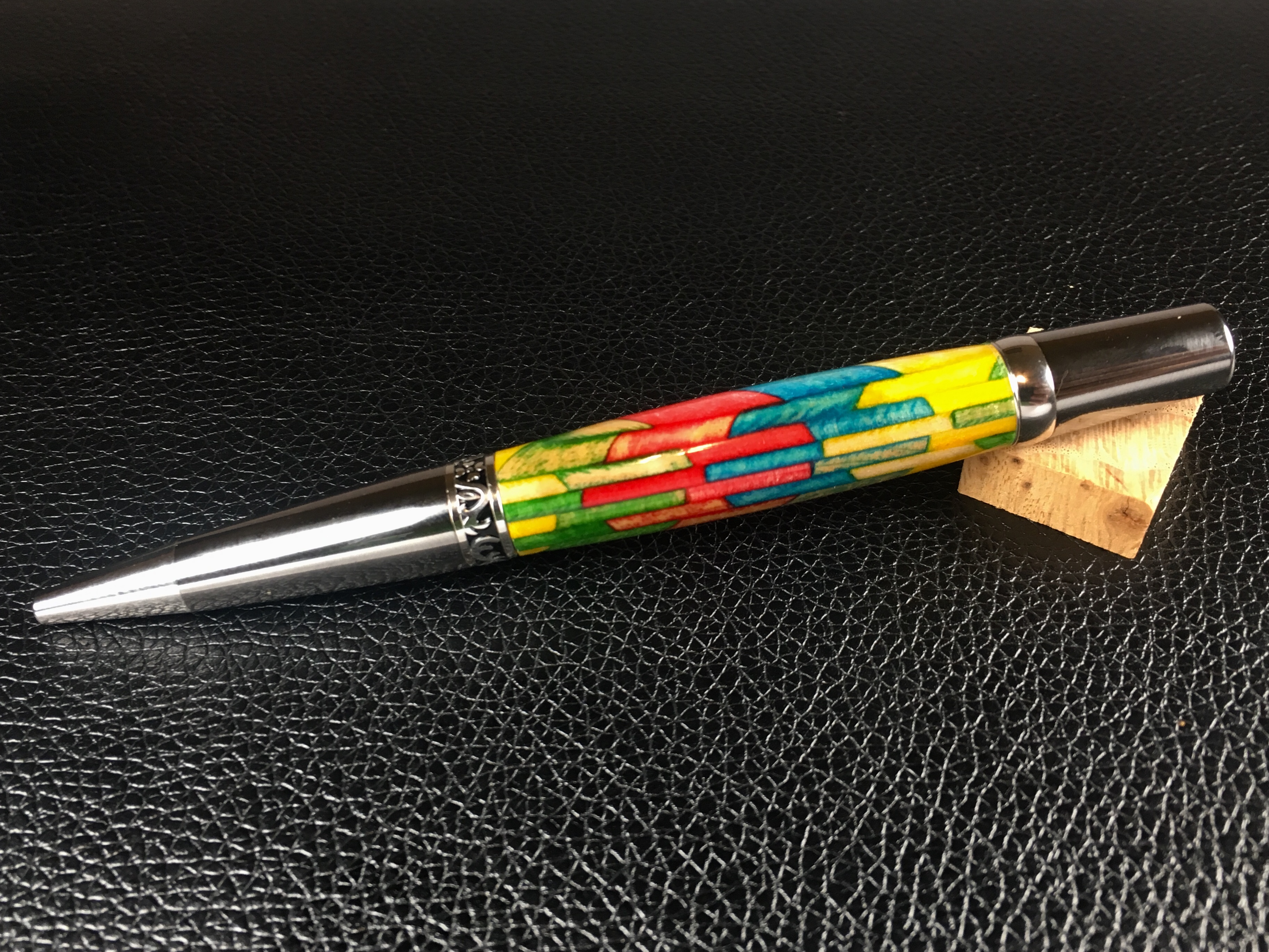

When it comes to pens, if you don't try it you will never know how it will look. I decided to try and make a pen out of colored Popsicle sticks. So with a 5 dollar investment I headed home and glued up a blank. I was not sure how it would turn out and worried that the colors would run when I finished it. The glue up job was a bit of a mess. It has sort of a Popsicle stick stained glass look to it.

I love it!!! Now the next Mission Impossible, layer each at 45 degree angles to each other. Or buy some dye and dye your own, this way you can create your own color schemes. To dye them, if you use a vacuum tank and you will get deeper color penetration.
Jon Jon I told you they would like to see your work. Hope you continue to show more and hope other youngsters show us old folks what the next generation has in store. Also hope you share some of your sales tactics with us too. Looks like you have a bright future in pen making if you stay with it.

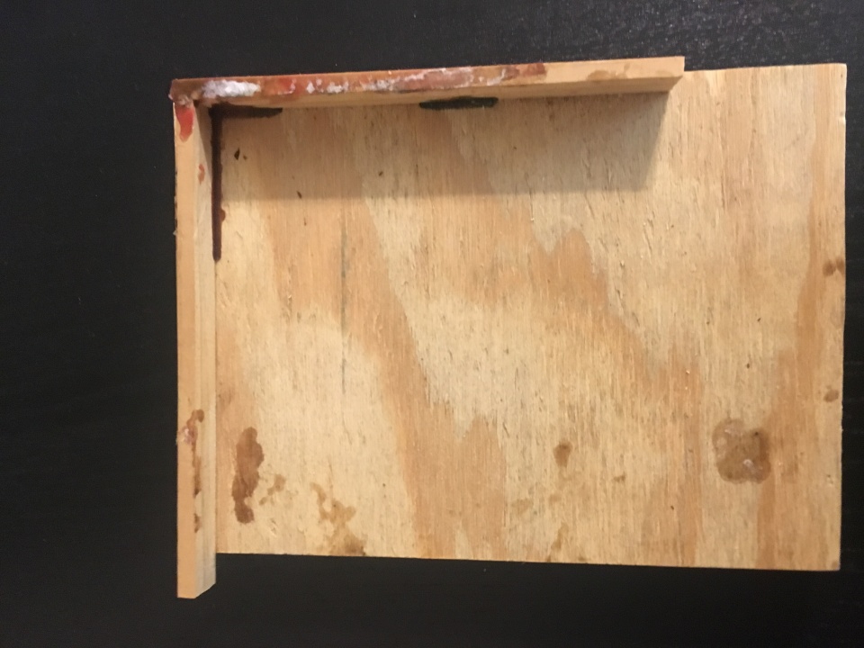

Edit: How about some info on the jig you built. Thanks.

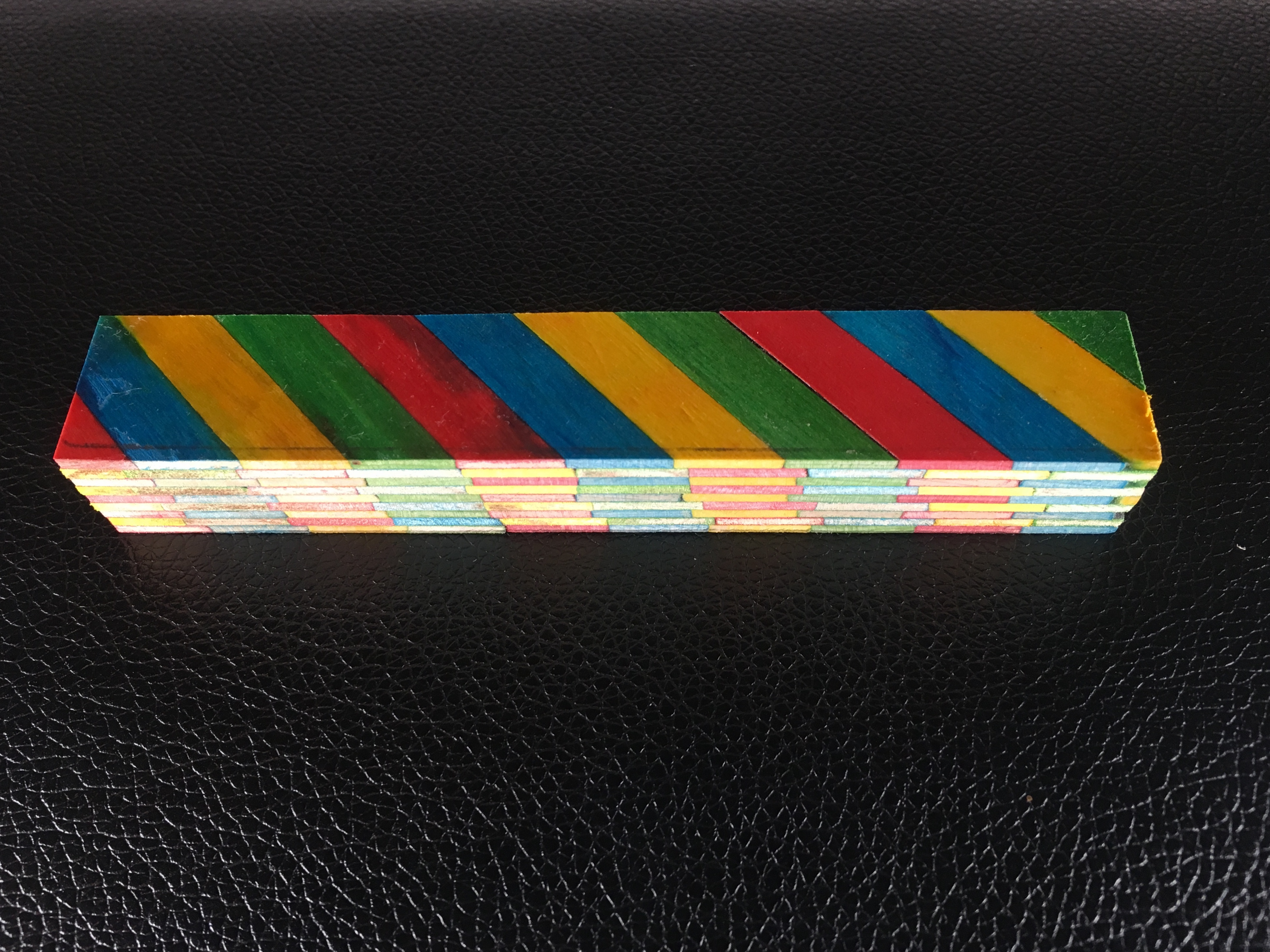

Gluing was the tricky part of this. I used titebond as well. I found two things helpful. First I made a simple jig to keep things square.(pictured below) It is simply a board with two strips attached a a 90 degree angle. With this everything stayed in place as I stacked the layers without slipping all over. Second was using enough glue, but not too much. Then placing the Popsicle sticks directly in place. It is the moving the sticks around that cause the colors to smear. That is where the jig helped.
I placed a piece of wax paper on the jig and then stacked the sticks with each layer at a 90 degree angle to the last layer. Then I place another piece of wax paper on top with a small piece of plywood on top of that and clamped it with four clamps.
It would have been very difficult for me with out the jig.
When all was dry I cut the blank diagonally from the block.

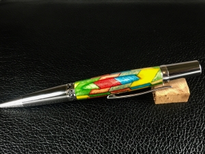

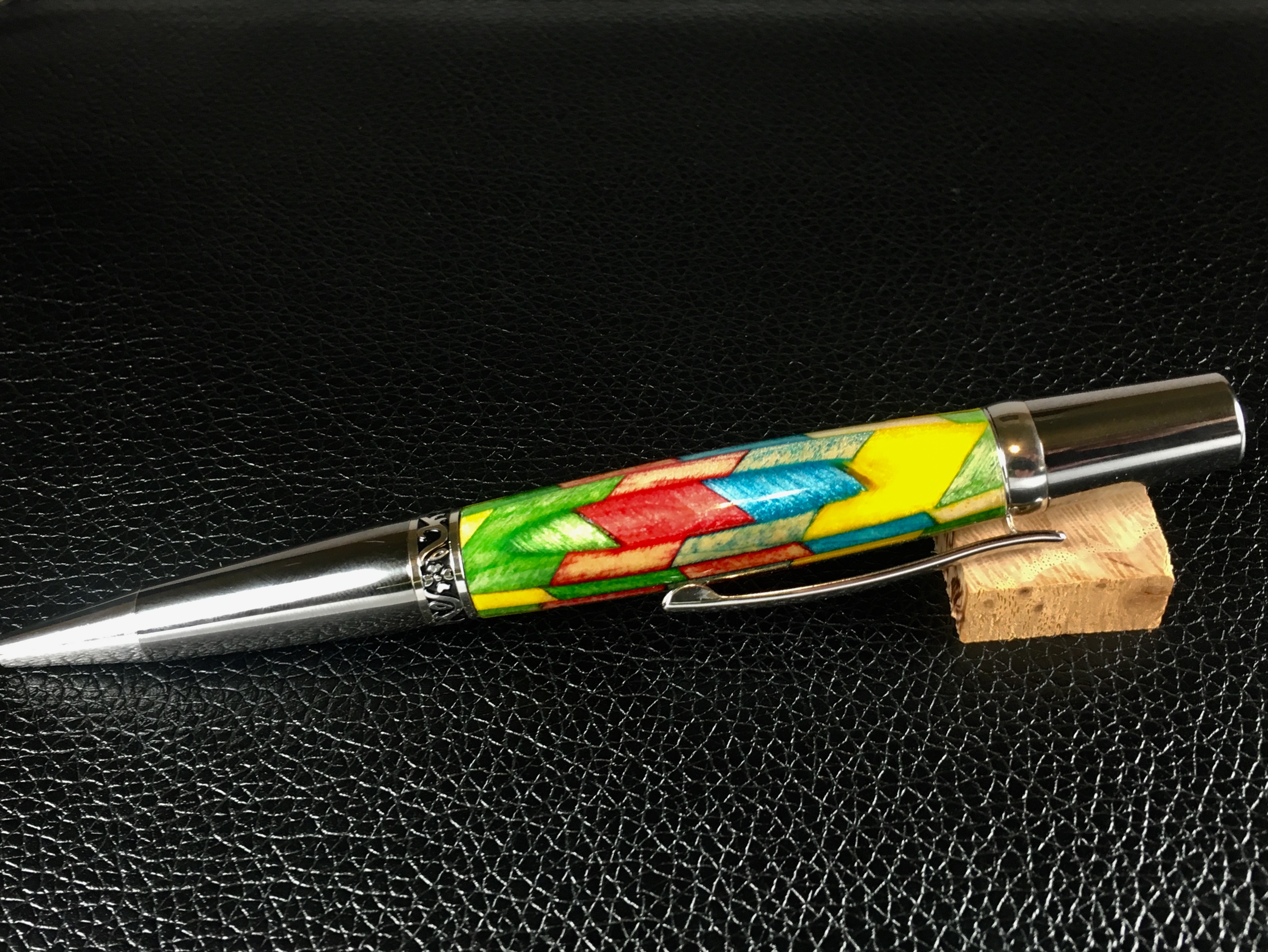

Did my first one today. Turned out interesting (I'm a newbie to this, BTW). Anyway, I think I'll have to try that herringbone pattern for a future turn...which seem to come every day.
