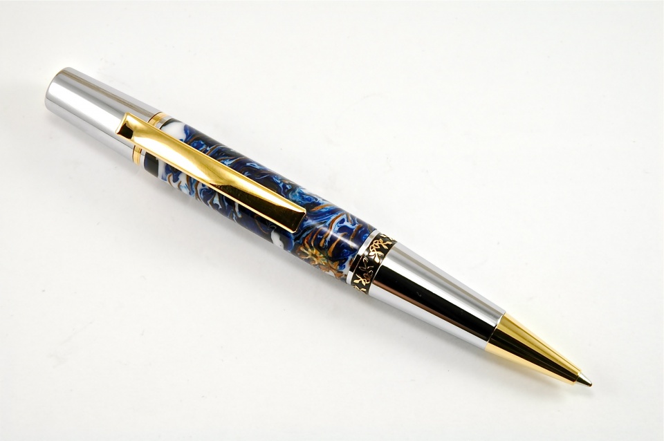

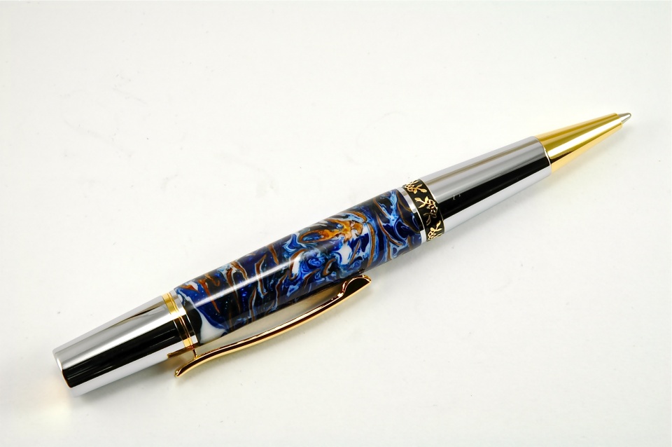

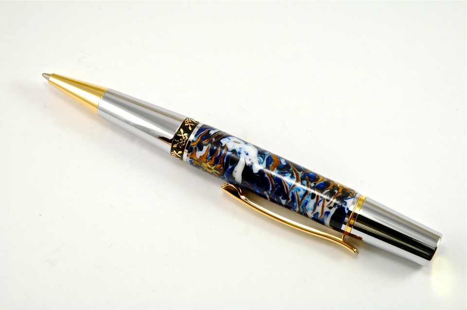

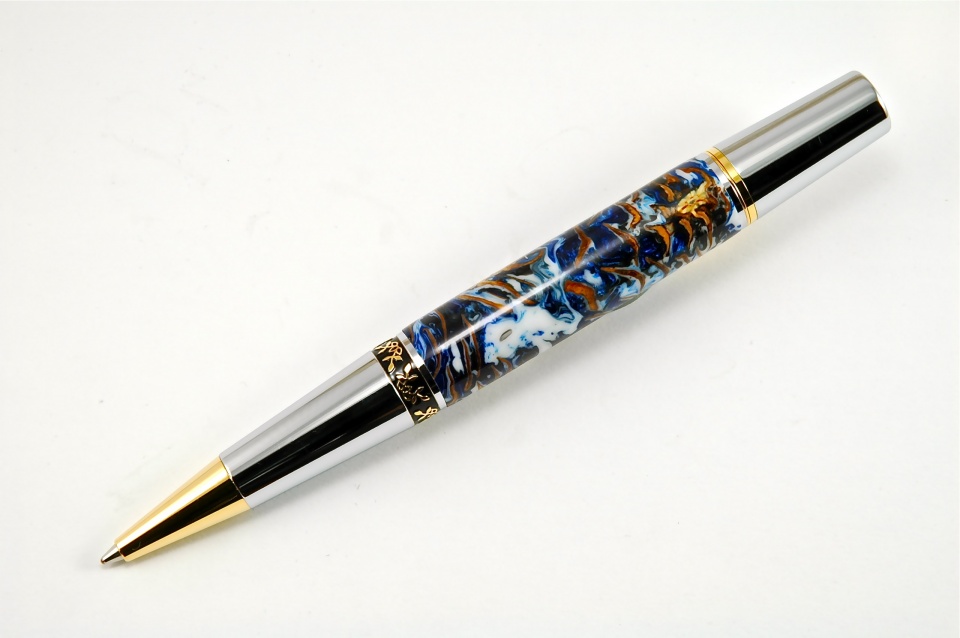

I know the little, tiny pine cones are "old hat" to most, but they are great fun to cast and turn! I used Alumilite Clear along with blue, black and white dyes and some white micro-pearl Pearl-ex. The finish is CA, 12 coats to be exact. Wet sanded with MM to 12,000.
C&C are welcomed, as usual.:wink:

That's awesome Mark. Tell me do you have some advice on how to make swirls and what are some of the main techniques?
Pointy objects!
Somebody out there probably has a better way of doing this, but I simply just use an "awl" or something pointed like a screw driver, etc. and just poke around and swirl the resin in-between the cones. :wink: You can get different results by waiting for the resin to set up a bit…not too long though!
I sometimes grow tired of the pine cone pens but this one is superb! It has just enough of the pine cone without it dominating the design. I love the swirls you infused into the design.
Very well done on both fronts ... the casting and the execution!
