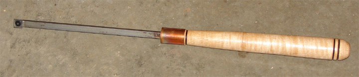

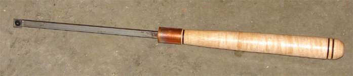

Since you asked, I did spend a few minutes on the grinder rounding the square stock prior to pounding it into the hole in the handle. This handle is made from a hunk of scrap figured hard maple. The ferrule is a copper coupling I bought and added almost $1.00 to the total cost of the tool. BTW, the overall length is 20". The steel shaft is 9" exposed. This might be a little too long for some folks taste but I believe it will make this a very versatile tool. You don't like, get out hacksaw.

Oops. Forgot to post photo with last post.

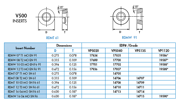

You can go into the Milling Cutters section and look at the specs for specific round insert cutters, you'll find the insert specs. They range anywhere from .275 to .630 for the RDMT-61 & RDMW 15 degree cutters.

Looking at the sale inserts I cant's figure out the OD's.
Here is a list of the available inserts for $2.00 - $2.80
RCMT1003M0 C2
RCMT1003M0 C5
RCMT1003M0 C6-GOLD
The "T" is the 4th character and is supposed to designate the type except I don't see a "T" on the list. I'm looking for counter sunk but not necessary.
The 5th character is the is the size. If I understand this means the "1" equates to 3\8" and "0" equates the thickness of 1/4"?

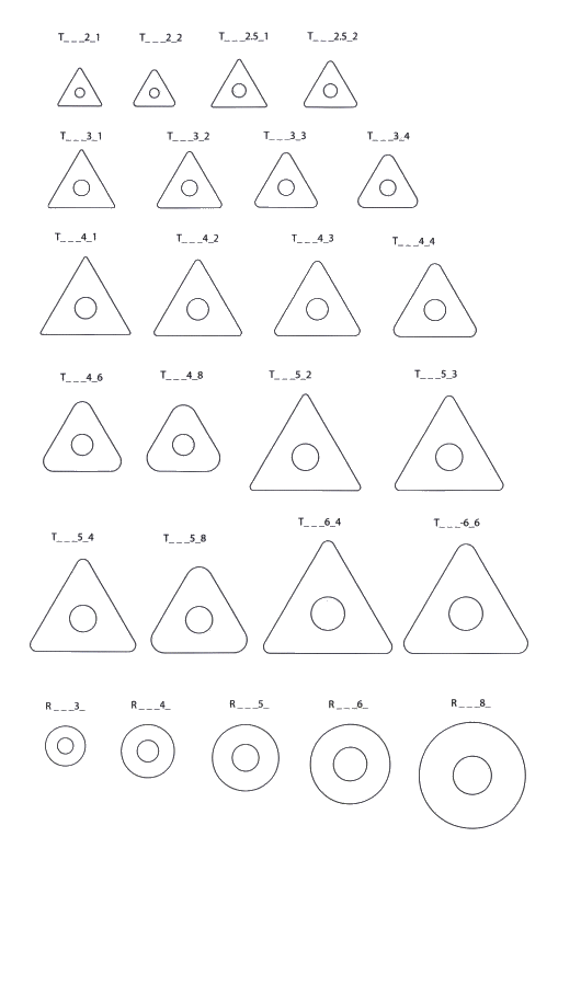

I don't think a "1" in the 5th character placement is 3/8" when compare to other cutters and their sizes. Here are others in comparison . . .
Here are some templates of various cutters. I only assume they are actual size . . .
Photos are from carbidedepot.com
