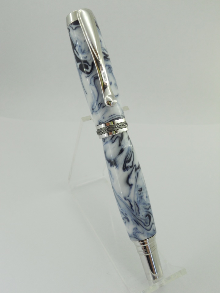

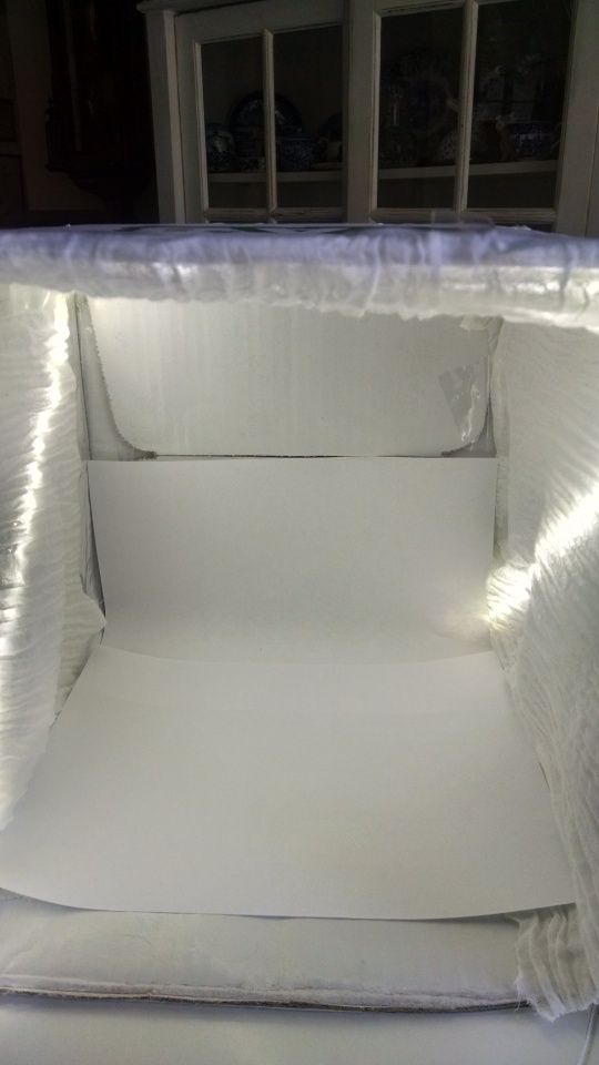

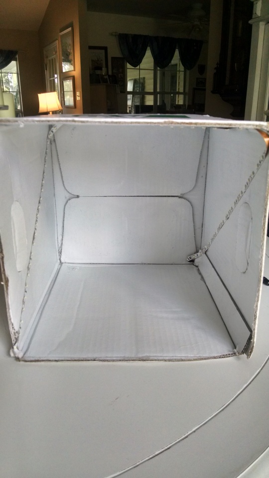

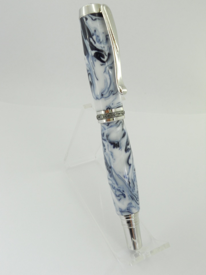

I'm just a poor country boy, trying to scrape by. Take 1 box, 1 led light kit from Amazon Amazon.com: LE® 12V Flexible LED Strip Lights Kit, LED Tape, Daylight White, 300 Units 3528 LEDs, Non Waterproof, Light Strips, Pack of 16.4ft/5m, All Accessories Included: Musical Instruments ,and some cheese cloth. The leds can be reduced to 50% / 25% / 100% with remote included with lights. Please see attached pics. I hung cheese cloth over lights so the photos were not to reflective of leds. This is still a work in progress, and I am not a photographer by any means, just looking to make my pics better. Enjoy!

Glad to see you got lights and box setup. The pictures are a strong improvement over the other "SOYP" photo's that you've posted.
I would put a piece of paper along the back/bottom so that it makes a curved surface. That will get rid of the background color difference that runs through the middle of your pen.
When I setup mine, I re-did photos of pens I had to see the difference. Comparing the before/after helped me tweak my setup more.
Good work, keep at it!

I guess I will be different about your DIY Box.
LED lights do not produce electromagnetic polarized waves.
But once LED light is reflected or softened it does , And once those polarized waves strike any nonmetallic smooth surface it creates polarized reflection. AKA glare.
You also have UV rays that create reflection or glare to.
Every light will create some kind of noticeable glare line on your pen.
The more lights and the more the light is reflected the more the glare lines to the point you are washing out the pen with reflection or glare.
Part of photography is technics used on certain types of photography like land scape or portrait photography.
If you think your DIY photo tent is a good idea and you think your picture are good then please join a photography forum and show them your pictures and tell them what technic and equipment you are using.
I think you pen looks very nice but honestly I thought your photograph could be done allot better.
I thought it was partially whited out with glare or overexposed....
I am not saying this to be anything but to be practical .
How many lights do you need to light up a 5 inch pen ?
Point being One light one glare line ...............................................
I don't know of any Professional photographer who is surrounding his subject with lights ........................................

I understand your point, as stated I'm not a professional photographer, just wanted my pics better....which the consensus says they are. I am not concerned with the uv, led, tungsten or any other light ray source just wanted my pics better not perfect. I post on a pen forum, not a photo forum with a cheap point and shoot camera. No offense taken, and I appreciate the constructive input.

NO, that DIY set up that he made is partially working against him.
It might work well for photographing clothing or something that doesn't have a smooth reflective surface.
Way to many lights, way to many glare lines.... for smooth surface reflective subjects .
A LED flashlight or desk lamp. Desk lamp would be the best because you don't have 4 arms and hands.
LED lights do not create allot of heat, ( safety issue heat )
and they do not produce electromagnetic polarized waves until the light is either reflected or softened and then it does....
The LED light will need to be softened , ( old tee shirt, white pillow case )
Optional If your camera can have a CPL mounted on the lens then I would buy a small piece of Linear polarized film and put it over the light and the material that is being used to soften the light. ( in other words the Linear polarized film goes on LAST ).
And us a CLP on you lens
That's what I would do if I was trying to photograph pens on the cheap.

I suggest covering the front of your light box with a piece of white paper or fabric with a hole in the front just large enough to photograph your pen through. That will help minimize the reflections from the room.

I would suggest the same thing but also add a dark or colored rod to one side to produce a dark shadow line somewhere other than in the middle. Imagine how dull a large ball bearing would be photographed in a box like this. You can add colors to the chrome by adding colored rods and have them move on diagonals by slanting them radically. It's easier than airbrushing in later.

Space your lights around the outside of the box (top, left, and right) equally, with some kind of thin white cloth to softly diffuse it.
For the background, white cardstock paper that gently slopes down from top to table level. Under the pen for contrast would be either something natural (slab of rock or wood) or some colored cloth to help bring out the colors in the item. Optionally, you could drape the colored cloth along the white cardstock background to change the background color.
Block out the front of the box except for a hole for your camera lens, to minimize color contamination from outside.
Don't use a flash.
Turn off the other lights in the room while you take your picture, to minimize outside light interference.
