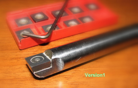

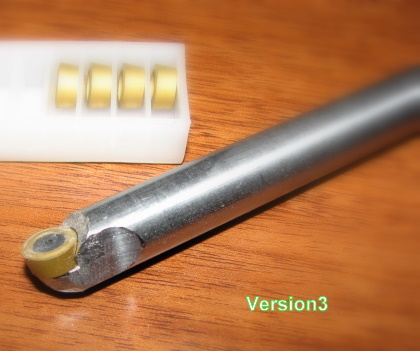

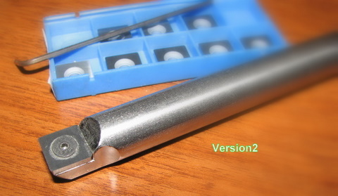

Had some unused things at work,played for a bit.
Used what was available,scrounging around:biggrin:
Cost = 0.00 on Timecard.
Fun trying it out = priceless.
cnc machines used = 0.
Went with round stock,so I could just stuff it in a drilled hole.
Shank has an 1/8" cross hole so i can pin it in a handle.
Version 1 works fair,needs "sharper" inserts.
Version 2 works pretty darn good.
Version 3 is ok,but could use "sharper" carbide.
Thanks for looking at my junk.:rolleyes:
Any comments always welcome.

Kurt,
Nothing too hard,just relax and enjoy the fun of making your own tool.
I used (because available) flat head socket screws,and what I had in the way
of old carbide inserts that were collecting dust.Rod stock was just cutoff scrap that I encountered.
Fit the body to the insert on a bench grinder,and drill and tap on what you
have available.You might drill and tap a bit too close,and then fine tune the back seat to get a snug fit.Just in case your drill walks or whatever.
If I were to buy inserts,i would get them with 20-30° relief angle like some
others who made similar tools recommend. mine are steel cutting inserts
and don't exactly dig in like there's gold to be had,but they cut with a good
amount of control.(in other words,they don't self feed to the tube in 1.1 nanoseconds!)
I like round shank tools,they feel more fluid to me when i turn,but the square could be ok too.
Post yours up when you get to them!
