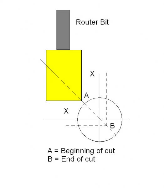

Here is a pictorial on how to make a pool cue blank with nice sharp corners and by using a simple jig, a router with a standard bit and the lathe just used for indexing.
It doesn't matter if you build a box over your wood lathe or make a template for you metal lathe. Remember, the lathe is only being used for the indexing. Unplug it before you start (Please:wink:)
I'll post all the pics first, which I think are pretty self explanatory and answer any question to clear up any queries.
There are just a couple of 'Rules' when using a standard router bit.
1. The 'Ramp' that the router moves along MUST move in both the horizontal and vertical planes by the SAME amount.
2. Each cut cuts beyond the centre of the blank. This means that after the first cuts, you end up with a void that is easily filled with CA and sawdust as you go.
This blank was made with a pine dowel and an unknown dark hardwood quadrant. The pine is softwood but maybe with enough coats of CA, I'll be able to use it.
Remember that as the blank is turned down, that the dark spikes will shrink in length.:wink:

Oh, I forgot to add.....
Routers can cut you quicker than any tool alive.:eek: Please be very careful.
The bit remains exposed until the job is finished. The instinct is to look at the cut you have just made as you take the router away.
If you have ever 'been-there-done-that' , you're ok, because you will NEVER do it again:biggrin: DAMHIKT:cool::doctor:

I just noticed that the A and B in the sketch are a different way around from my reference points on the plastic guide. If the drawing is correct, then the A should be on the RHS and B on the LHS on the plastic.
But I'm sure you figured that out:tongue:
For those that build something like this, (or a box over the wood lathe bed,) then try to build it so that you don't need to move anything to glue and clamp the bits together.
The shape of the plastic guide I used is of no relevance, it's just used for other stuff too.
Also please note that if you manage to get a perfect point bit ( any angle) then the cuts would be made only with a horizontal ramp. The vertical movement isn't needed because you would do the cuts from above the blank and not on the side, like this.
To make nice long cuts like these, you will probably have to join your blank onto another one or make a plan to leave space for the router.
If there are any pics that need explanation or any questions please feel free to ask.:biggrin:

Skippy,
Awesome tutorial. Thanks for sharing your ingenuity and skills. There are many more applications that this type of segmenting can be used for. Now if you could just come up with a way that the wood shavings don't go all over the shop that would be a neat trick.
Vacuum cleaner??:rolleyes: :tongue:
...... Now I gotta figure out what kinda router to get, etc. that will work on my lathe. Any suggestions, it's a jet mini.
I used my 1/4 inch router because the base was small enough not to get in the way. You guys get a different style of router to us. I think Porter Cable was the first to have the method where the motor body screws into the base to adjust the bit hieght. They are extremely rare here. But a neat design. But any router would work. Palm Routers are great but for some reason they are most often more expensive than their bigger brothers.

Skippy,
I think I have worked this through in my head but I have to ask anyway...
When you use the router bit to cut your material away, the bottom part of the cut has a bit of a radius to it where you stop cutting due to the radius of the bit. When you put your colored wood into it, you don't worry about that radius. Right? Because the very end of the cut is going to be cut away anyway isn't it? Or is that where you talked about having to use CA and sawdust?
Hope that made sense....

Skippy,
Yep, spot on. You can see the ca in a couple of the pics ( 3rd and 4th cuts) and like you said, it gets cut off anyway. It is just to keep it solid to the section in the chuck. In one of the pics I showed the dark quadrant rounded on one of the corners, this just takes up some of that gap. :wink:

Great tutorial Skip!
Just wondering what angle the the inserts are cut at? Im assuming that the big takes out a 90deg slot, so the insert is a a 90 deg section?

Hey Steve, I know you used a 90 degree cutting bit. I have a v-groove cutter for my dremel. I'm gonna attempt to make a setup I can use on my lathe. I'll be cutting from the top, so will only need to adjust the depth of the cut. Does this sound right to you??

Ernie, yes a V cutter needs only be done from above. How big is your cutter and do you think the Dremel will cut beyong the centre of the blank? Good luck with it, please let us know if it works:wink:

Alright Steve 2 more questions for you. How close to the actual size was the blank when you started cutting. Also about how long was the piece when it was finished??
I've got a dremel 300 series with a 1/2 v-groove cutter used for cutting points in actual pool sticks. I've got to do some mods on it to fit my lathe. It's designed for use on a Taig Lathe. Like I said my buddy makes cues and has several Taig Type Lathes, but I decided I'd make mine work. Also gonna have to index my chuck. But that should be a breeze.

You can also make a slide to come in from the side with the 90 degree bit. Would be a bit easier to adjust the angle, Just make a flat guide for the router and trun it towards the blank at the needed angle. I made a fixture similar to one shown in a previous post for a friend to use on a mill.

Out of curiosity, instead of "inlaying" the 4 point square dowels one at a time, why not replicate the way they actually make house cues? They are made using one larger square that has 2 V shaped cuts taken out on both 90 degree marks of the blank. (did that make sense?)
Google, "Full Splice Pool Cue Construction" if my explanation wasn't good enough ;)

OR ... you can get a old broken pool cue from the bar or local pool room.
They are already made like that ... just bigger.
When you reduce the diameter the points will shorten (move toward the back end) so take that into consideration when you cut the blank.
It is best to cut your blank much longer than needed until you get the diameter close to the finished size so you can see where the points will be.
One pool cue = one pool cue pen. Lots of waste.
