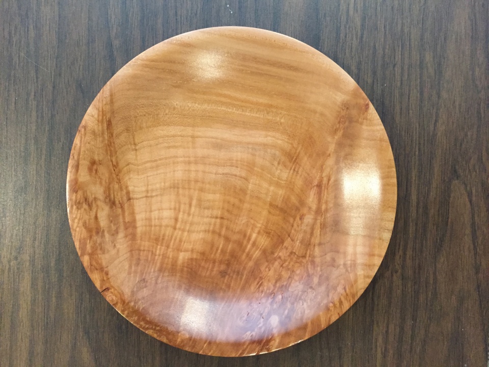

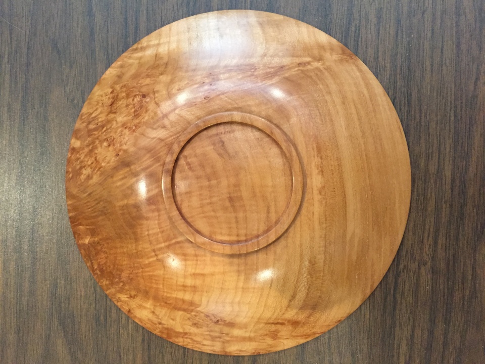

I really like a high gloss finish on things I turn. I know that there are others who find such finishes 'plastic' looking, but I like shiny stuff.
I have tried a lot of different finishes on bowls. I recently finished a Redwood bowl with pure tung oil and liked the result. Before that, I have used Deft 'rattle can' gloss and was generally happy with the result (other than the occasional orange peel from bad technique).
I have read about Polymerized Tung Oil and thought I would give it a try. I ordered a quart from Sutherland Welles. At $44.13 per quart, plus $16.71 shipping, it was a bit pricey. It turns out a little of this stuff goes a long way, so I could have ordered a pint, but it is what it is.
The bowl was sanded to 400 although I should have spent more time on a couple of end grain issues. I went back and forth through the grits several times before I applied the finish.
It was a bit of a learning curve, but I think I have done all right. The can instructs that application should be with "a natural bristle brush or a clean rag". Later, I discovered their web site defines a rag as "Scott Blue Paper Towels" which I had missed. I first tried cotton cloths, but I found I was taking too much off when I followed their instructions to wait 5 to 10 minutes and remove the excess. I went to paper towels for application and removal (not Scott Blue, but quality paper towels) and the result was much better.
I have pictures of the Maple bowl I finished. The picture was taken with my phone, so it isn't the best quality, but I hope it does the finish credit. I purposely included a glimpse of the end grain issue, so you can see my procedure isn't perfect. I am constantly learning, yet never quite there.
I like how it turned out. Your comments, and your suggestions are most welcome. I hope this proves useful to someone.

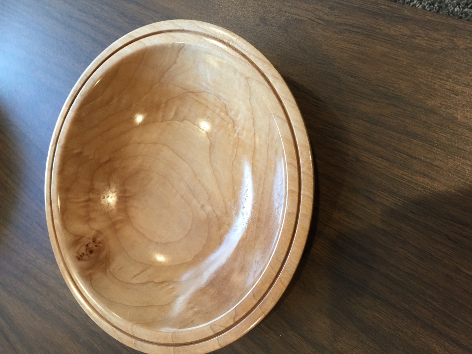

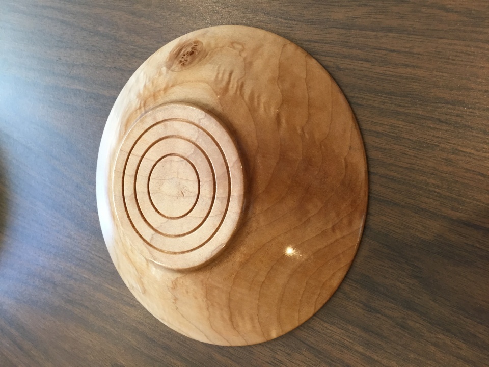

An Update:
I just finished a bowl similar to the one that started this thread. This blank is another one that my friend Charlie (Dieseldoc) gave me out of his 'rough turned' stock. I REALLY wished I had taken a picture of this before I finished turning it. I was amazed at the figure that was waiting inside. It was beautiful! Thanks so much Charlie.
This time, I went back to Gloss Deft Spray Lacquer. As you may be able to see in the accompanying pictures, the gloss isn't as shiny as the Polymerized Tung Oil. I improved my spray finishing technique (I mentioned that I sometimes had problems with orange peel), using 0000 steel wool in-between applications; the result is a very smooth surface with noticeably less sheen, but I think it looks really nice.
According to Deft's instructions, I waited 30 minutes between coats. I sprayed the bowl in my garage to reduce issues of it drying too quickly because of the sun, and to eliminate wind blowing stuff on the wet surface. I applied probably 5 or 6 coats.
I like both the Polymerized Tung Oil and the rattle-can Deft, and learned a valuable lesson in the process. I need to SLOW DOWN and really look carefully at the item to be finished and NOT RUSH into the application of the finish. I also need to be careful all along the way. When the "little voice" whispers in my ear that I need to reconsider, I need to listen. Patience is a bit hard for me.
I always learn from comments and suggestions, so fire away!

Charlie did you well with that blank. Great looking!
I am not one to be preaching about finishes as I have rushed my shares of finishes in the past, but you hit upon one of the greatest needs for wood workers, wood turners and pen turners in general. When the product is done except for the finish, we tend to rush the finish. The finish is what shows off and show cases the beauty of the wood or construction.
A fine frame showcases a great picture. Finish is what showcases our products. Finish often takes more time than making the product, and it will show.
