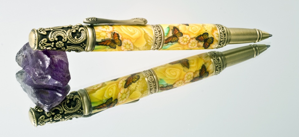

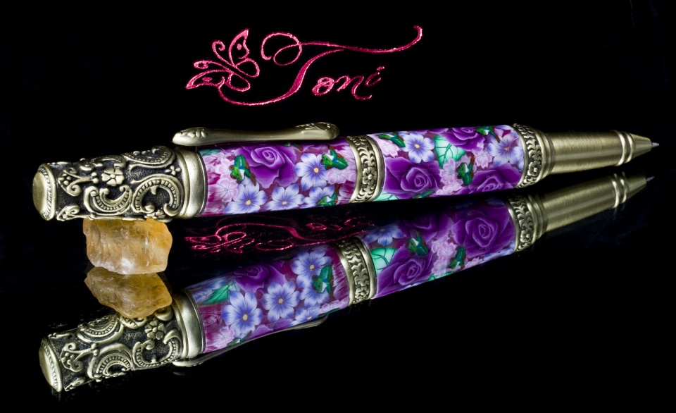

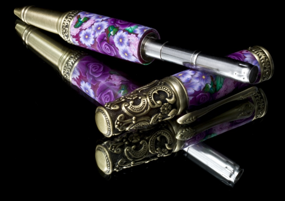

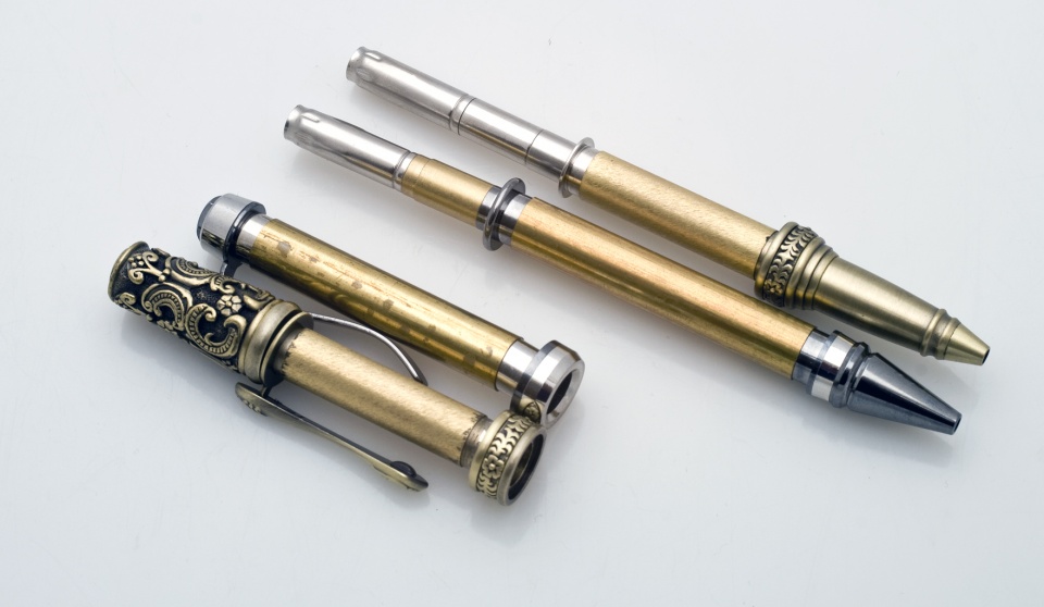

Here we have something rather new. Tubes for Victorian pen kits!
attachment.php
attachment.php

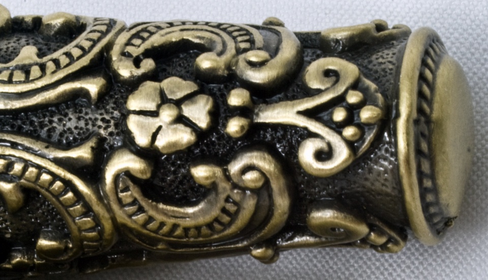

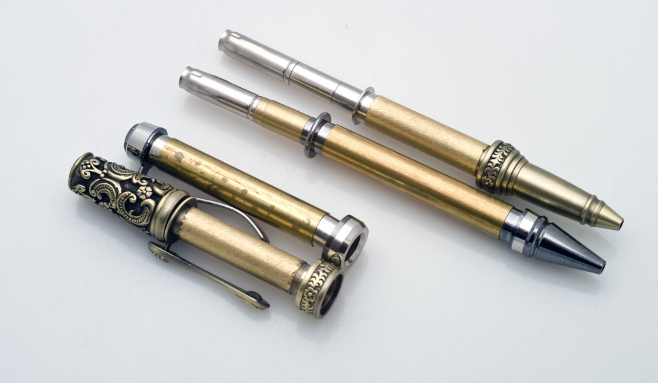

Few things worthy of note on the Victorians.

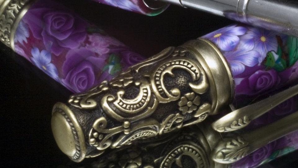

  • Victorian's are essentially bling-afied cigar's ;)
    attachment.php
    attachment.php

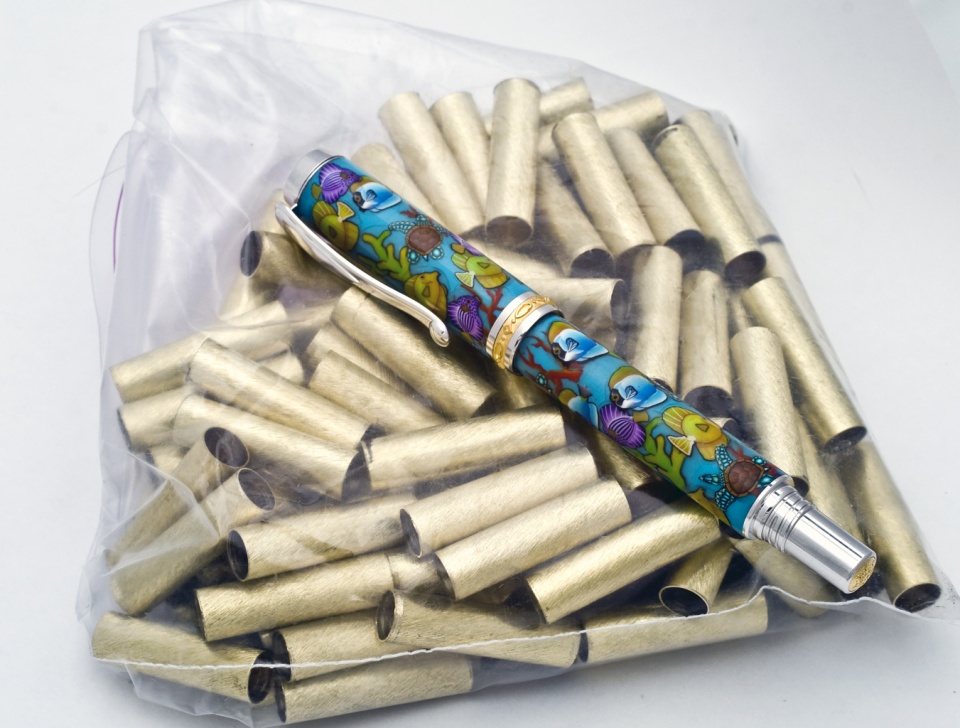

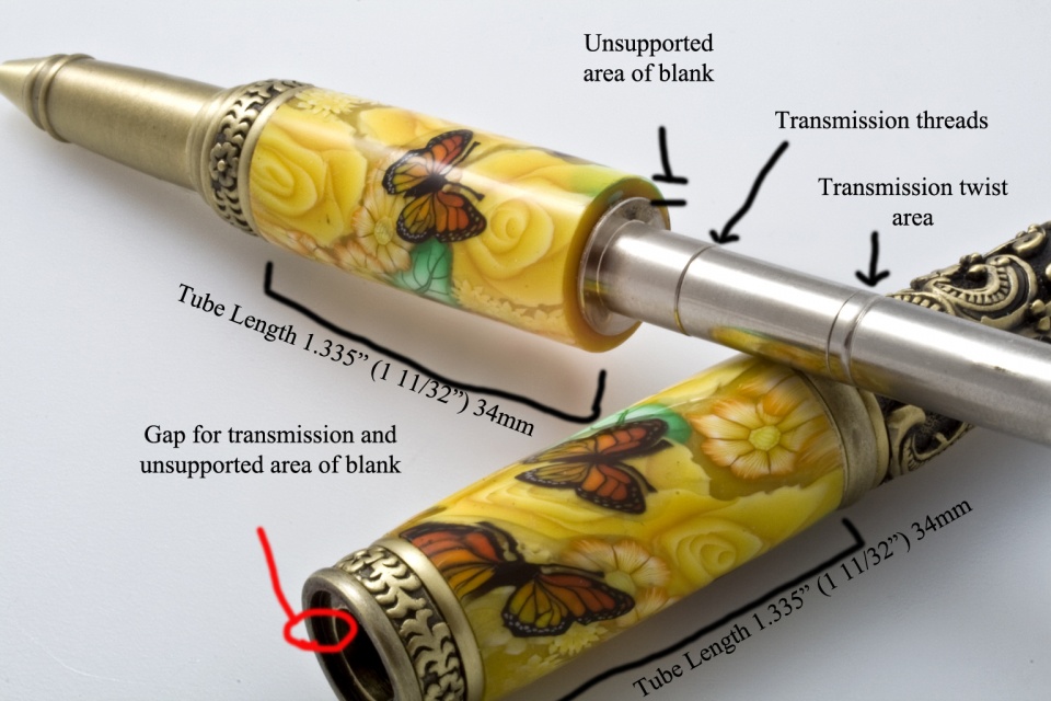

  • The lower tube section is that of a cigar, standard cigar rules apply.
    attachment.php

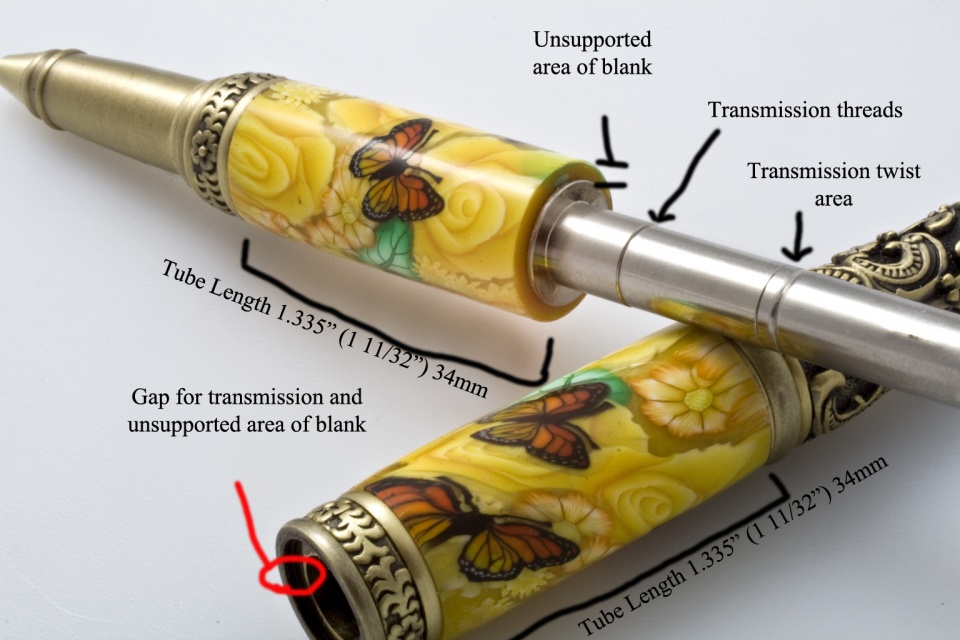

  • Lower tube length is critical! The upper tube length not so much, you do have some play room but not that much.
  • The 'unsupported' area is when the pen is taken apart. When together the support is given via the center band.
    attachment.php
