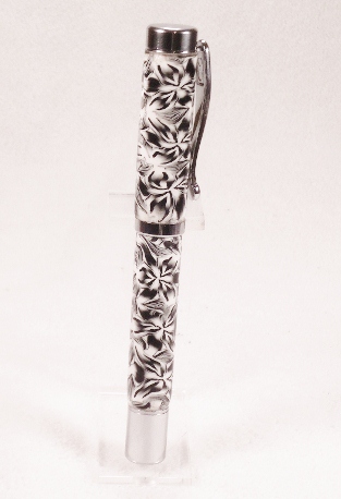

Toni; Thank you for the nice comment!! Comming from you that is realy an honor for me. I hope you didn't take the "no turning" the wrong way. I ment it only as a way of saying that you do not have to have special turning equipment to make a Polymer Clay pen. Keep that beautiful work comming. Jim S
There's so many creative ways to apply polymer clay to pen designs. I'm sure everyone has their own ideas, but in summary, there are some noted differences in making clay blanks you can turn and clay blanks ready made for pen assembly.
I create clay blanks primarily for pen turning. Sometimes I create sheet designs, but I normally apply the cane slices directly to the tubes and back fill with secondary patterns of similar coloring. I know Keith and a few other people also create clay blanks that can be turned. I think a few of them have already shared their methods as well, either in this thread or before.
The pre-assembled blank designers have their own techniques which Jim has already shared and I'm sure Toni can clarify more if needed. I think historically the idea originally came from polymer clay nail art designers, which is very thin clay slices applied to women's nails for decorations.

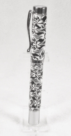

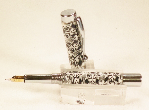

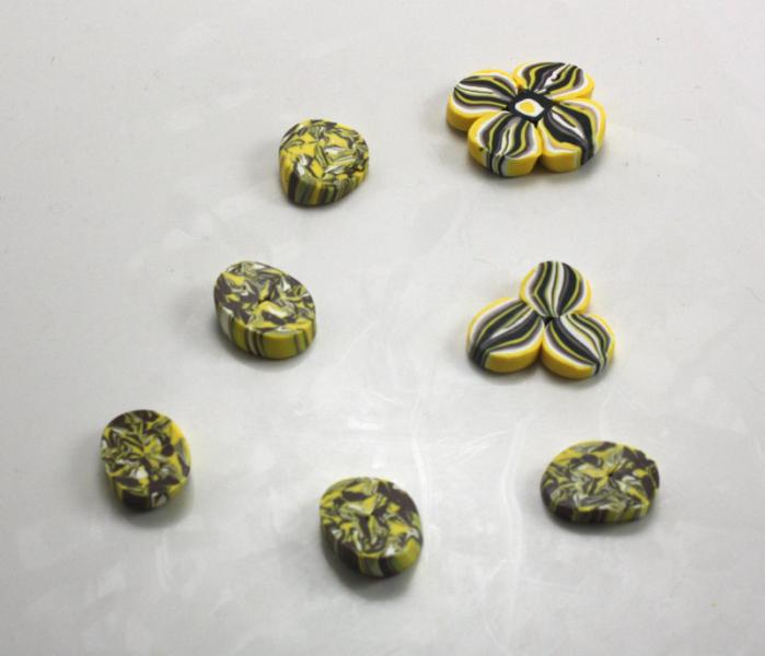

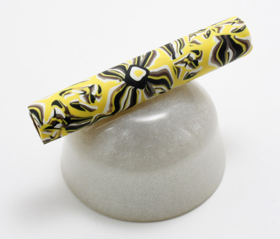

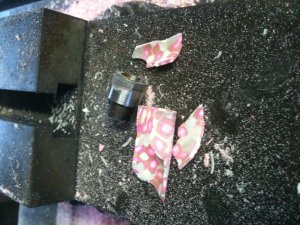

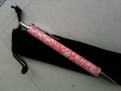

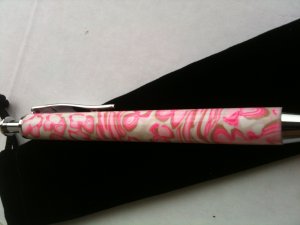

Sculpty blank
I decided to give polymer clay a try. I had some very old Fimo that was dried out and not usable. My local store had some original sculpty so I picked it up, armed myself with a few youtube how to videos and went to work.
Here is the tube with the clay applied.
Here is a video of turning the 1st blank. I cooked it 20 minutes @ 275 degree.
http://youtu.be/OQuSVuRHaGE
100%
100%
The results of trying to sand it. The paper I was using had holes in it that caught the corner and destroyed it.
So I went back and built another. This time I cooked it for about 25 minutes. I turned it the same way, but used sand paper more carefully at the end. The initial sanding was with 400 grit, then I applied about 7 coats of CA (5 thin, 2 thick). I then finished it by sanding up to 12000 and plastic polish.
What do you thnk?
Dan
Dan; Very nice pen !!! I will shape my Polymer Clay blanks with small metal files after I turn them round. I always sand my Poly blanks by hand with the lathe off, going from end to end after applying a coat or two of thick CA. Remove all shiny spots with 220 than 600. I than apply 6-8 coats of thick CA. Sand with 1200 and polish. Everyone does it a little different. Remember clay is a lot softer than wood, so light pressure is the key. Jim S
