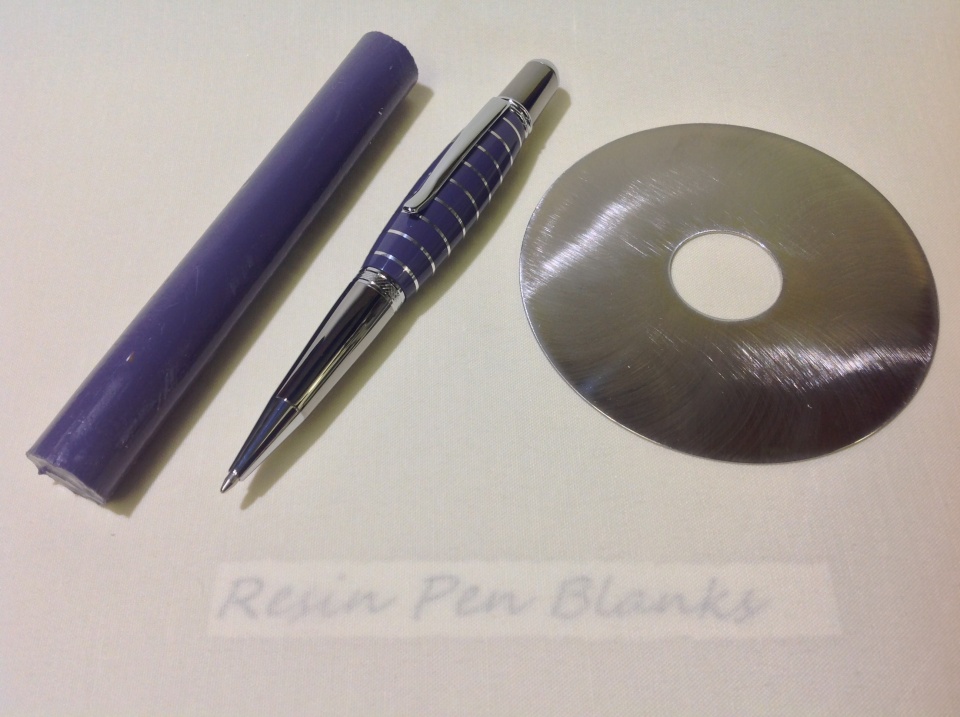

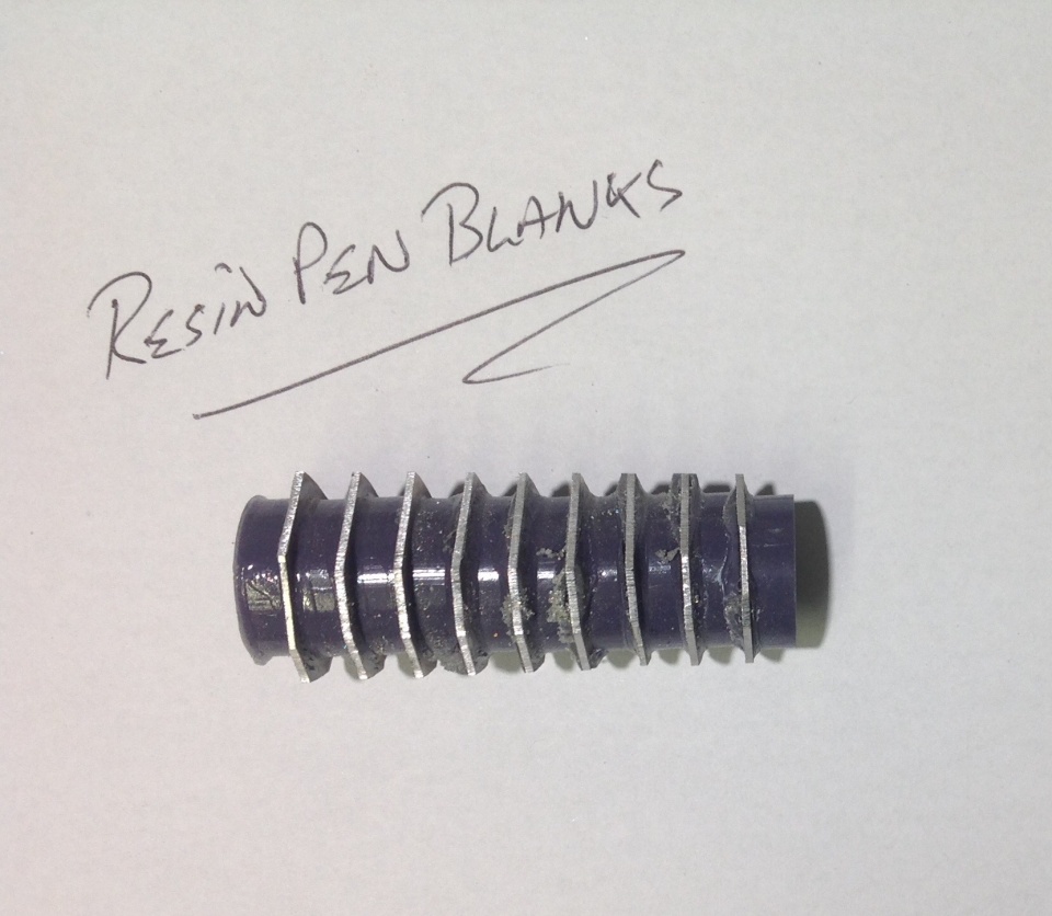

Here is a Sierra kit with one of my custom colour polyester resin pen blanks segmented with a computer HDD platter. Just the right thickness of aluminium I think. Thanks for looking, hope you like it. C&C's welcome.

Nice !! . Have you tried cutting "washers" out of the HDD platter using a hole saw ?
Thanks. No but I am going to do something to make it less wasteful. I need to create a jig to drill and cut them out as easily as possible. This is my first attempt so I will keep developing. Your holesaw suggestion is a good one.

How did you get the resin discs so nicely identical in thickness ?
I just set a stop on the bandsaw. The next one I do will have slightly thinner slices so the end ones are closer to the rest.

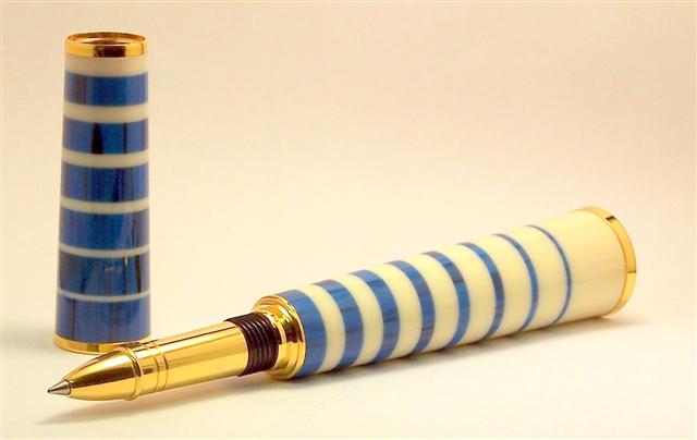

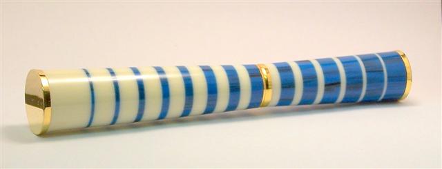

One of the most intriguing pens to me was one created back in 2008 by SkipRat:
http://www.penturners.org/photos/images/3090/1_kpen4.jpg
http://www.penturners.org/photos/images/3090/1_kpen5.jpg
No metal spacers but the spacing was amazing to me.
I should let him answer but if you are in a hurry here is what I think ....
I am quite sure that he has disassembled a hard disk drive (HDD) and used the metal platters, which are aluminum.
A CD is not made of aluminum but is a tough plastic material (which you could do the same thing with).
" with a computer HDD platter."
Forgive my ignorance, does that mean a CD?
Mag pen still is correct, I always recycle old hard drives from computers. They have a couple of very strong magnets inside and the older ones have multiple platters (aluminium discs) inside. The new HDDs tend to only have one platter due to the significant increase in data writing efficiency.
Hope this helps.
