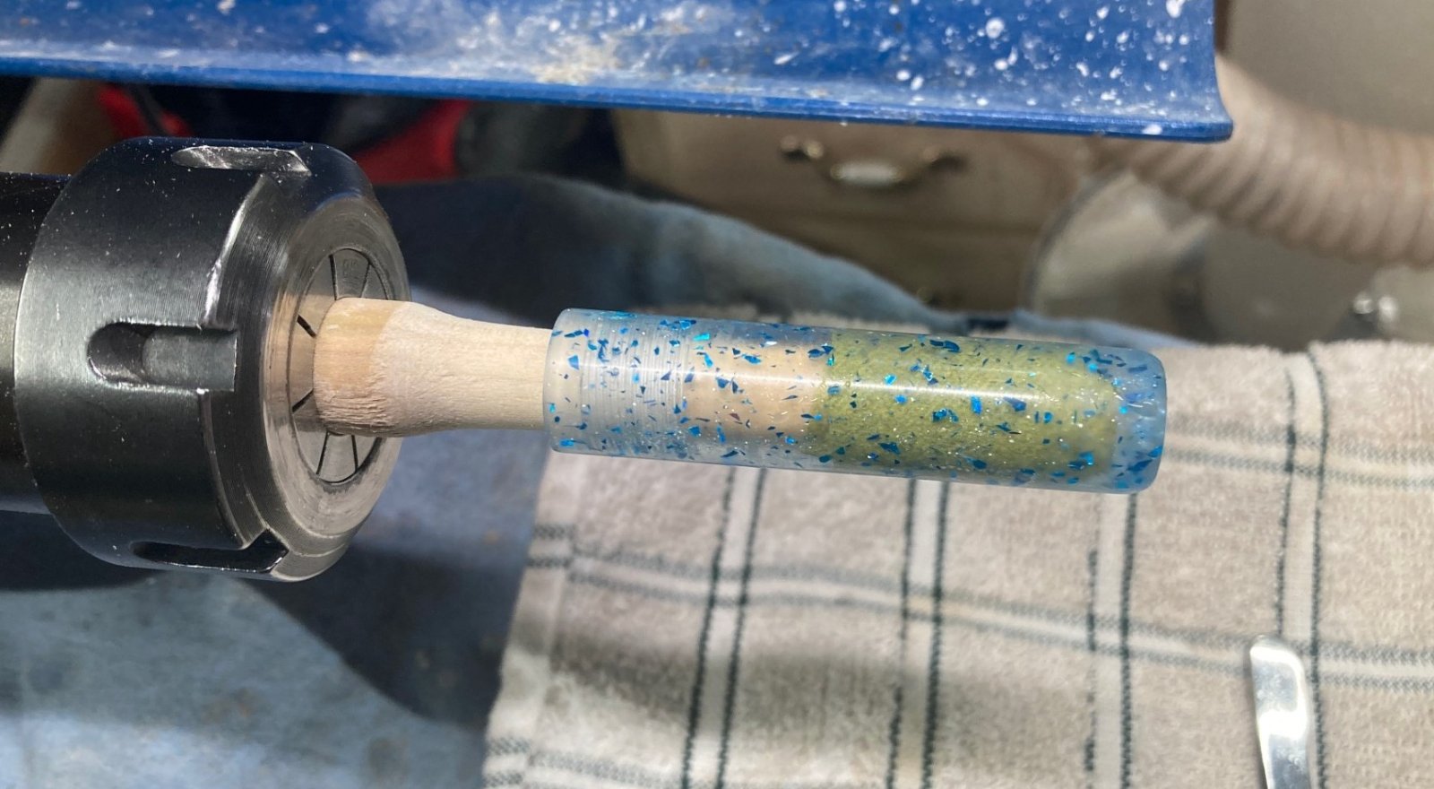

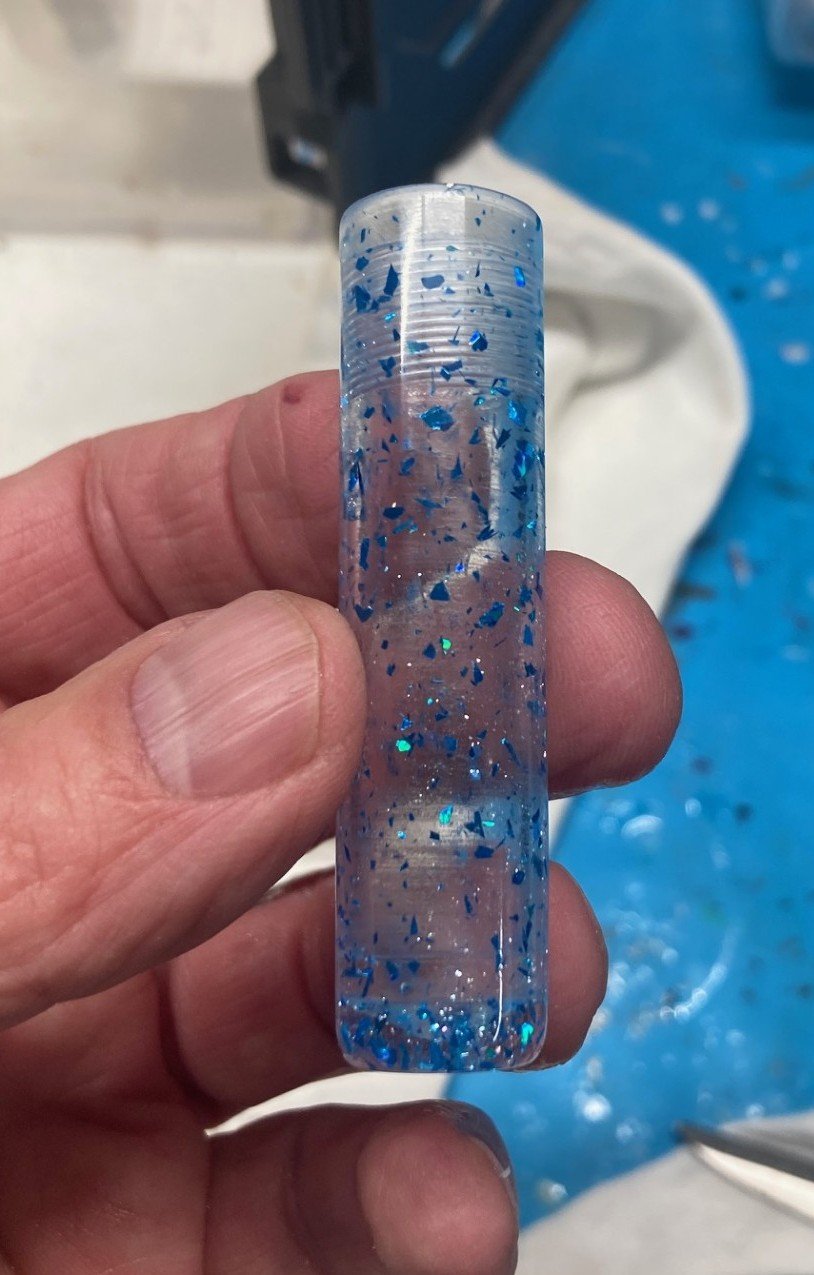

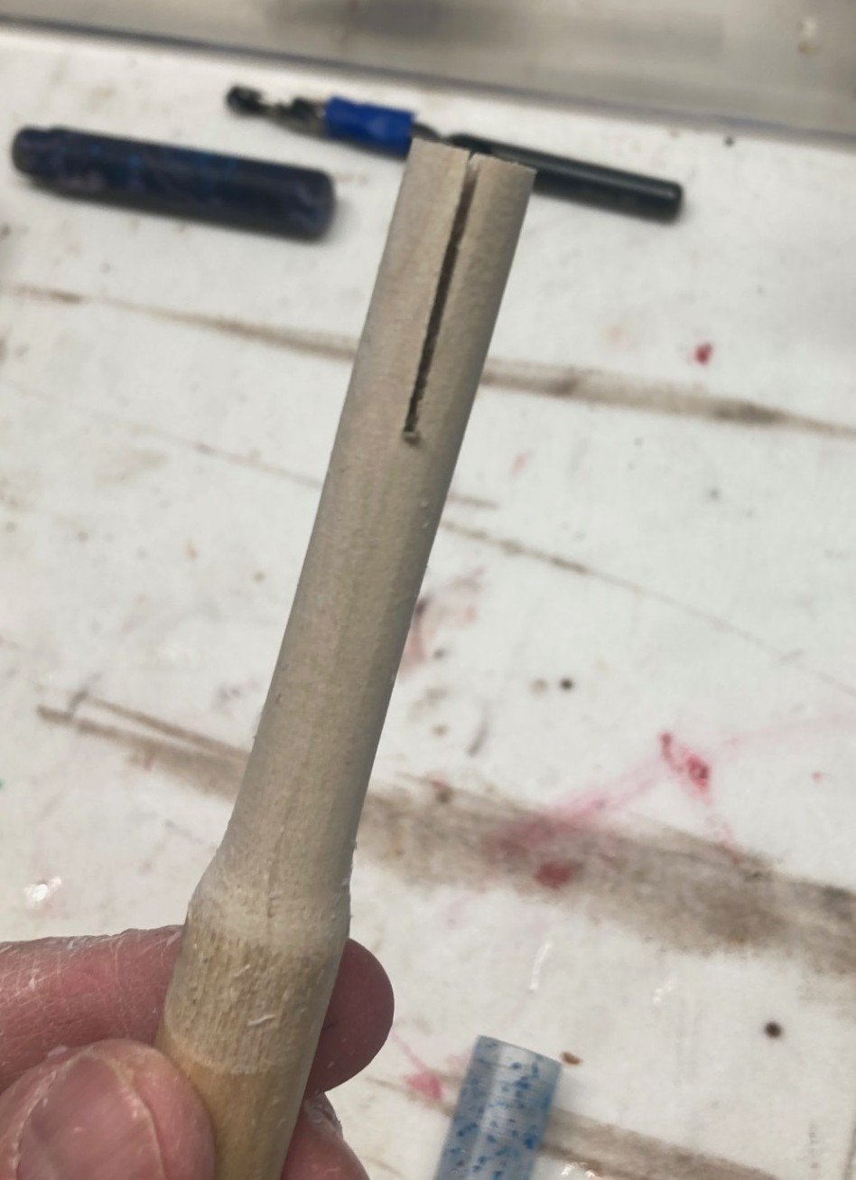

I watched a couple of videos from the links y'all gave me - this was much easier than I thought it would be. See pics below.
The "Before" picture
Made a split dowel to hold the Zona Paper
Zona Paper on the dowel, using lathe to turn the dowel.
The "After" picture
