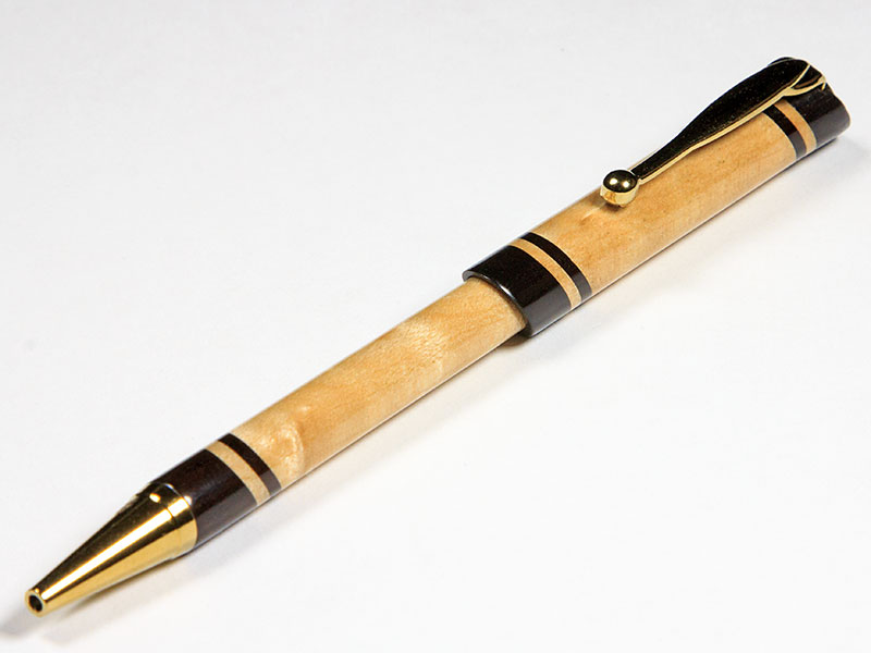

Unpolarized glare, part 1
Remember I said that whether or not a direct reflection polarizes light is dependent (in part) on the angle of reflection? Well, in my posts on "polarized glare", I placed the light at an angle that produced a polarized reflection.
In this post, however, I placed the light at a different angle -- one that produced a glare line, but such that the direct reflection is not polarized. See the four photographs below. I took them all with a polarizing filter (CPL) on the camera lens, rotated in approximately 45 degree increments.
attachment.php
Unlike my images with polarized glare, rotating the filter had little effect. The glare line is relatively unchanged in all four photographs. Even though the blank material (wood and CA glue) is non-conductive, the direct reflection at this angle is not polarized, and a polarizing filter does not eliminate it.
So, what can you do to cut unpolarized glare? Well, there are multiple approaches. Some of them are more effective than others. Some are more expensive than others. Some are simpler than others. I'll be going over a few of the options in future posts.
I hope that helps,
Eric

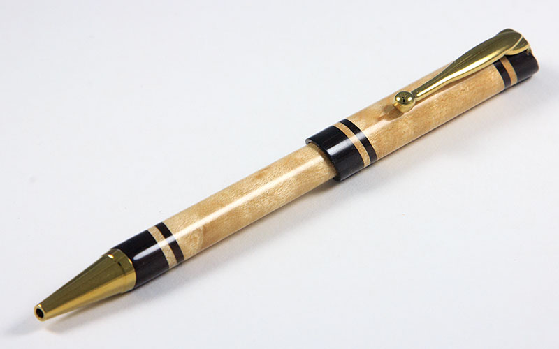

Unpolarized glare, part 2: cross-polarization

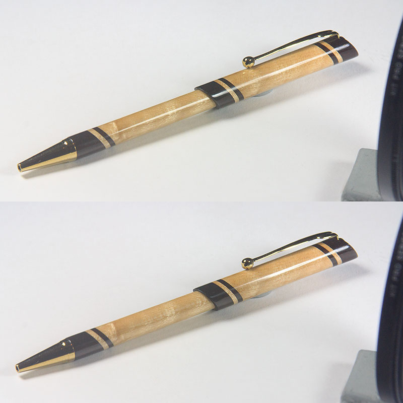

So, if your pen photo composition produces unpolarized glare (as in post #41), and a polarizing filter either before or after the reflection doesn't affect it (as in post #41), what can you do?
Well, there is a technique called "cross-polarization" that can still cut the glare. The trick is to use two polarizing filters -- one before and one after the reflection. That is, you put one linear polarizing filter over the light, and another on the camera lens. The photos below illustrate the effect. You can see one of the filters at the right edge. It covers the lower barrel of the pen. There is another polarizing filter on the camera lens.
attachment.php
In the top image, the two polarizing filters are aligned. That is, they are rotated so that their axes of polarization are parallel. You can see that they had no effect on the glare.
In the bottom image, I rotated the filter on the camera lens 90 degrees. Now the axes of polarization of the two filters are perpendicular. The glare on the bottom barrel is gone.
How cross-polarization works:
Remember I said that the glare (in post #41) was unpolarized? Well, what that really means is that the angle of direct reflection is one that neither polarizes, nor deploarizes the source light. Whatever polarization the source light produces is retained in the direct reflection. Because the source light (CFL with reflector in this case) is unpolarized, the glare (direct reflection) is too.
Well, by putting a linear polarizing filter over the light in this post, I've changed the pen's illumination (on the lower barrel) from unpolarized to polarized. The direct reflection (because of the angle) does not depolarize nor reorient it. Therefore, the glare is now polarized.
Because the direct reflection (glare) is polarized, a polarizing filter on the camera lens can block it out. When the two filters are oriented perpendicular to each other, the direct reflection is completely removed.
Two notes:
  1. I placed the first linear polarizing filter over the pen's lower barrel but not the upper barrel. The upper barrel is still illuminated with unpolarized light - which is why the polarizing filter on the lens did not cut the glare when rotated.
  2. The wood of the pen barrels produces diffuse (not direct) reflection. Because diffuse reflection does depolarize light, the polarizing filter over the light does not change the wood's appearance (other than acting as a neutral density filter). Again, because the diffuse reflection off the wood is unpolarized, rotating the polarizing filter on the camera lens does not cause that part of the image to darken.
In short, cross-polarization removes unpolarized direct reflection from a photo, but leaves diffuse reflection alone.
Additionally, linear polarizing filters act as neutral density filters to unpolarized light. Therefore, cross-polarization typically requires you to increase the exposure by 2 to 3 f/stops (or a 4 to 8 times longer shutter speed).
I hope that helps,
Eric

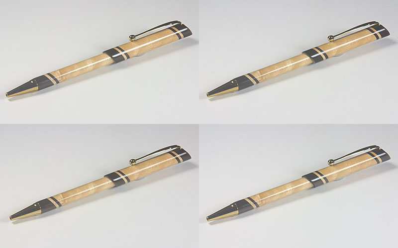

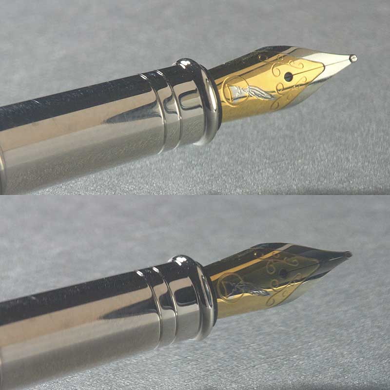

Unpolarized glare, part 3: how cross-polarization fails
Ok, thus far I've said that
  1. Glare is a form of direct reflection.
  2. Direct reflection off wood pen barrels can be polarized or unpolarized (or a mix).
  3. Polarized direct reflection can be removed via simple polarization (without affecting diffuse reflection).
  4. Unpolarized direct reflection can be removed via cross-polarization (without affecting diffuse reflection).
And, in post 43, I showed that cross-polarization is an effective technique for reducing or eliminating unpolarized glare on wood pen barrels.
That is not, however, the whole story. To take the best pen photographs, You need to understand that:
  1. Although glare is a form of direct reflection, it is not the only form. Direct reflection does not necessarily present as glare.
  2. Pens are made of more than just finished wood. They usually have at least some polished metal parts. Polished metal typically produces very little diffuse reflection. Like mirrors, they primarily yield direct reflection.
  3. If you use cross-polarization to eliminate glare on wood pen parts by removing direct reflection, you'll also eliminate the direct reflection that illuminates the metal pen parts.
Here are a couple of photographs demonstrating that effect. They show a fountain pen nib lit to show detail on its face.
attachment.php
The top photo was taken without cross-polarization. In the bottom photo, the nib is cross-polarized. You can see that the direct reflection off the nib just about disappeared. If it weren't for some reflection off the background material and a little ambient light in the studio, the nib would have turned completely black.
That is the downfall of cross-polarization in pen photography. If you use it to eliminate glare on wood or plastic parts, it will also turn your polished metal pen components dark.
Don't lose hope though. Polarization is not the only means to control glare. There are ways to light a pen that yield good illumination of wood, plastic, and metal parts and give nice specular highlights without glare. I'll be getting to them in future posts.
I hope that helps,
Eric

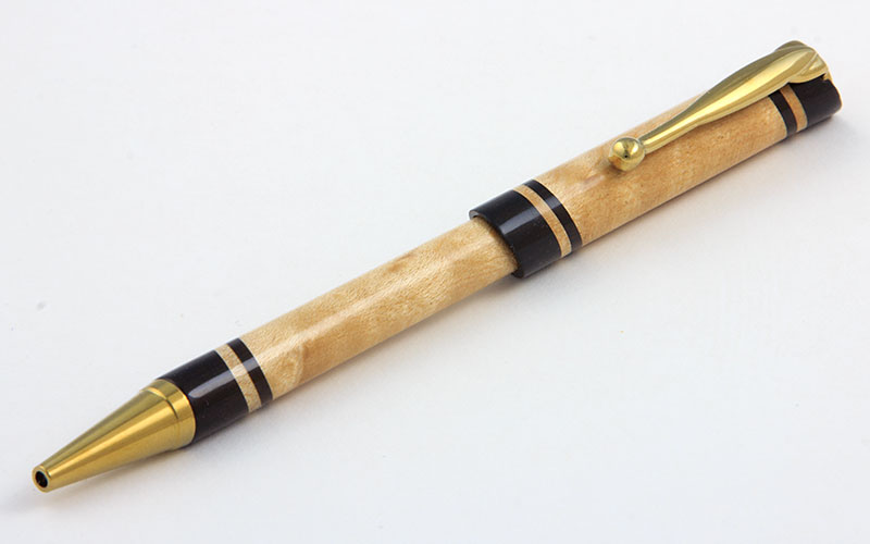

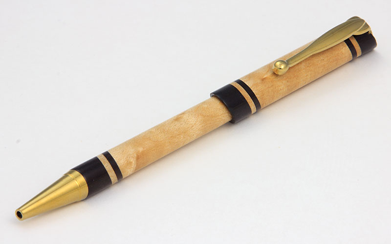

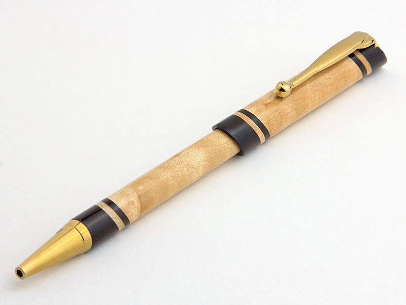

Eliminating glare by moving lights
Probably the easiest way to eliminate glare on pen barrels is simply to avoid it outright. Remember that in post #38 and post #39 I placed a light at a position that would yield polarized glare, and that in post #41 I placed a light such that it would produce unpolarized glare. Well, in the photo below, I moved the front light (the photos in all four posts were taken with 2 lights) to a location that did not create a glare line at all.
attachment.php
How is this possible? It's simply a matter of positioning the lights, and angling the pen so that the range of angles that exhibit glare are pointing somewhere other than into the camera lens. If you are use strobe lights, that task can require some careful thought, or some trial-and-error, but if you have continuous lighting, it's simply a matter of moving things around until the glare disappears.
Yes, it's that simple. Note, however, that although the pen blank is brightly lit with no harsh glare, the pen hardware is not. I'll present solutions to that problem in future posts.
I hope that helps,
Eric

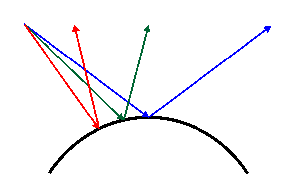

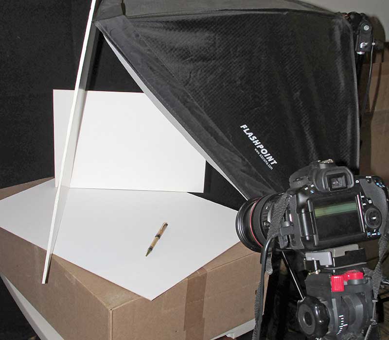

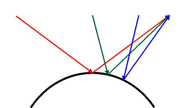

Managing direct reflection part 1: large light
So far, you've seen that you can control glare on wood or plastic pen barrels simply by changing the position of your lights. You may also have noticed, however, that in post 45, there is still glare on the metal parts (the nosecone specifically), and that the metal components are unevenly illuminated (dark patches).
How do you fix that? Well the key is to understand that diffuse reflection (as produced by the pen barrels) scatters light across a wide range of angles, but direct reflection (off the metal components) bounces off only at the complementary angle. Here are a couple of illustrations of how the angles of direct reflection work. The first diagram depicts a point light source reflecting directly off a curved surface (such as a pen nosecone).
attachment.php
Note that the reflections off different locations go in very different directions. Now consider how direct reflection off a curved surface affects what a camera sees.
attachment.php
The reflected light that reaches the camera lens comes from widely different original angles. If you only had one point light source, that spot on the curved surface would be lit, but nothing else would be (just like the photo in post 45). To fully illuminate the curved surface, you need light coming from a very wide range of angles.
Photographers call this a "large" light. Here's an example. I replaced the two 6" diameter lights I used before with a 20"x28" softbox and two reflectors (simply pieces of white mat-board).
attachment.php
The pen is now lit from almost all the way around, either by the softbox, or by reflection off the mat-board. This is the result.
attachment.php
The barrels are still evenly illuminated (mainly diffuse reflection), and now the clip and nosecone (direct reflection) are as well. The small dark patch on the clip is reflection from the front, where the camera is. You can reduce that spot, but you can't eliminate it completely (except by editing the image later).
There still is a small amount of glare (uneven direct reflection), but that's not necessarily a bad thing. It helps give the pen a sense of shape and can show off the surface finish. The glare in this photo is subtle because the direct reflection comes from all around the pen instead of just one angle -- and therefore has much less contrast.
I'll discuss other sources of "large light" and ways to control exactly how much glare you get in a future post.
If this topic is helpful to you, please let me know. Without any feedback, I can't tell if this thread is useful, or just something taking up lots of my time.
Regards,
Eric

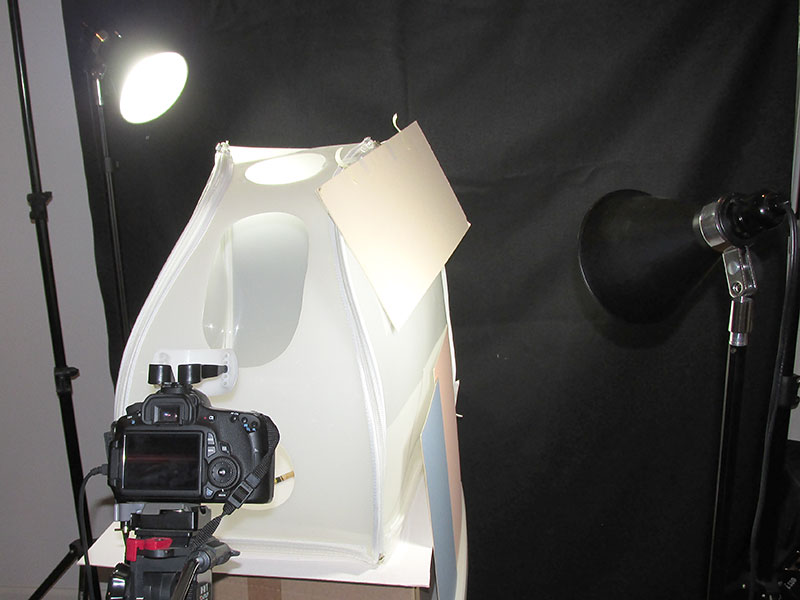

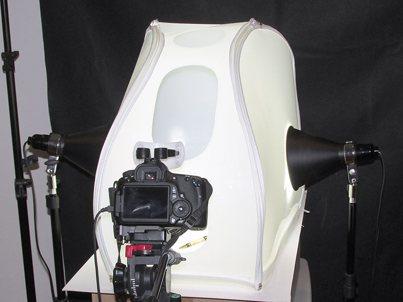

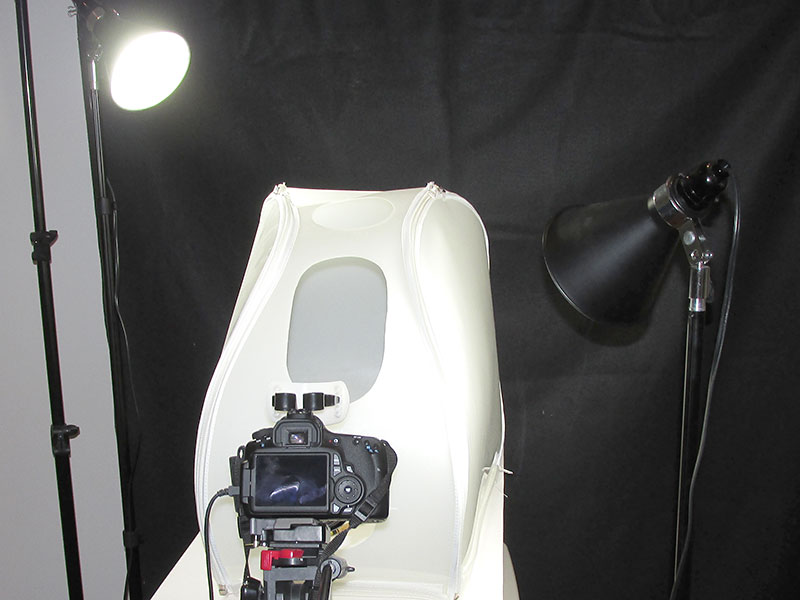

Managing direct reflection part 3: the light tent
So far, I've mentioned two sources of "large light". One is a softbox and reflectors; the other is an overcast sky. Neither is ideal for pen photography though. You don't need to go buy expensive photo equipment nor wait for the weather to take nice pen pictures. Instead, you can buy a simple light tent - or even build one yourself quite cheaply.
A light tent is basically just a box made of translucent white material. You put your pen in the box, and point your lights at the walls. The lights illuminate the box, and the box illuminates the pen. That way, you get a "large" light for more complete direct reflection off the metal pen components. For a more complete explanation, see http://www.penturners.org/forum/f24/photography-basics-why-use-light-tent-121808/.
A light tent by itself, however, is not a cure-all. You still need to be careful with the position of your lights. The most common problem I see with photos taken in tents is putting the lights too close. Here is an example:
attachment.php
In the picture above, you can see that I've put the lights right up against the tent walls. This tends to defeat the purpose of the light tent. Remember, the idea is make a large light. When you only light a small spot on the wall, however, you still wind up with small patches of illumination - that is, small lights. You can see the effect in the pen photo below:
attachment.php
Although this may be a little better lit than with no tent at all, there is still a strong glare line and the pen hardware has large, relatively dark areas. To fix that, you need to move the lights farther away from the tent.

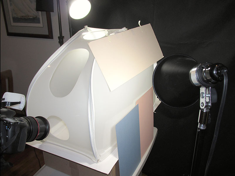

Managing direct reflection part 4: the light tent (continued)
So you've seen what happens if you put your lights too close to your light tent walls. Now here is an illustration of placing them farther away:
attachment.php
In this demonstration, I've pulled the lights away from the tent. One is on the left, illuminating the left and rear walls. The other is on the right, illuminating the right and front walls. They're pretty far back, casting fairly even light across the entire tent.
Here is the image that even light all-around produced:
attachment.php
You can see that the pen hardware is nicely lit, and there is no glare off the wood nor metal components. The image, however, looks a little flat. Without any specular highlights, it's tough to see the shape of the pen or the quality of the finish. Remember that I said a little glare is not necessarily a bad thing? Well, this photo could use some.
One solution is to try to strike a happy medium with light placement. You can move one of the lights a little closer, so that it lights the entire tent wall, but does so unevenly. Then the brighter area will yield some shine. If you have a light tent, go ahead and experiment with light placement to see for yourself.

Managing direct reflection part 5: the light tent (concluded)
In my previous post, I said you could vary the distance between the light tent and the lights to control the amount of shine/glare on your pen. This generally works, but you don't have a lot of control over the shape of the highlight. In my opinion, straight, well defined edges in the shine look better than an oblong shape. A simple way to achieve that look is to block some of the light that reaches the tent wall as shown below.
attachment.php
attachment.php
I've taped pieces of mat-board to the light tent to produce a rectangular bright spot on the wall. Photographers call this a "go-between" or "gobo" for short. The mat-board controls the shape of the highlight; the distance of the light controls the highlight's brightness.
This is the result:
attachment.php
You can see that the hardware is still nicely lit, but with better definition of the shape. The wood pen barrel has a highlight that shows off the finish without washing out the detail. It may not be perfect, but I think it's the best pen photo of this series, and I'd be happy posting it in the Show-Off-Your-Pens forum. What do you think?
That completes what I planned to say on the topic of polarization and glare, unless anybody has questions or comments. I hope it helps people improve their pen photography skills.
Regards,
Eric
