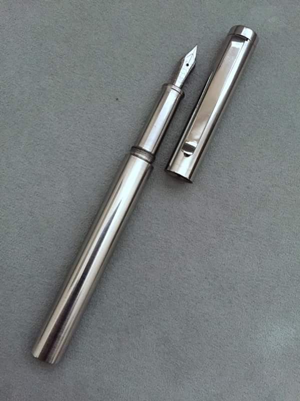

I've made pens from SS my little 7x10 mini lathe without issue including single point threading. Used cutting fluid for turning and drilling.
