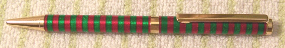

Here's a simple Christmas pen from green and red acrylic ---
-- as mentioned above, cut squares, sand flat surfaces, glue (I used thin CA),
clamp, drill, reverse paint, glue in tube and turn (with sharp tools)
Joe
