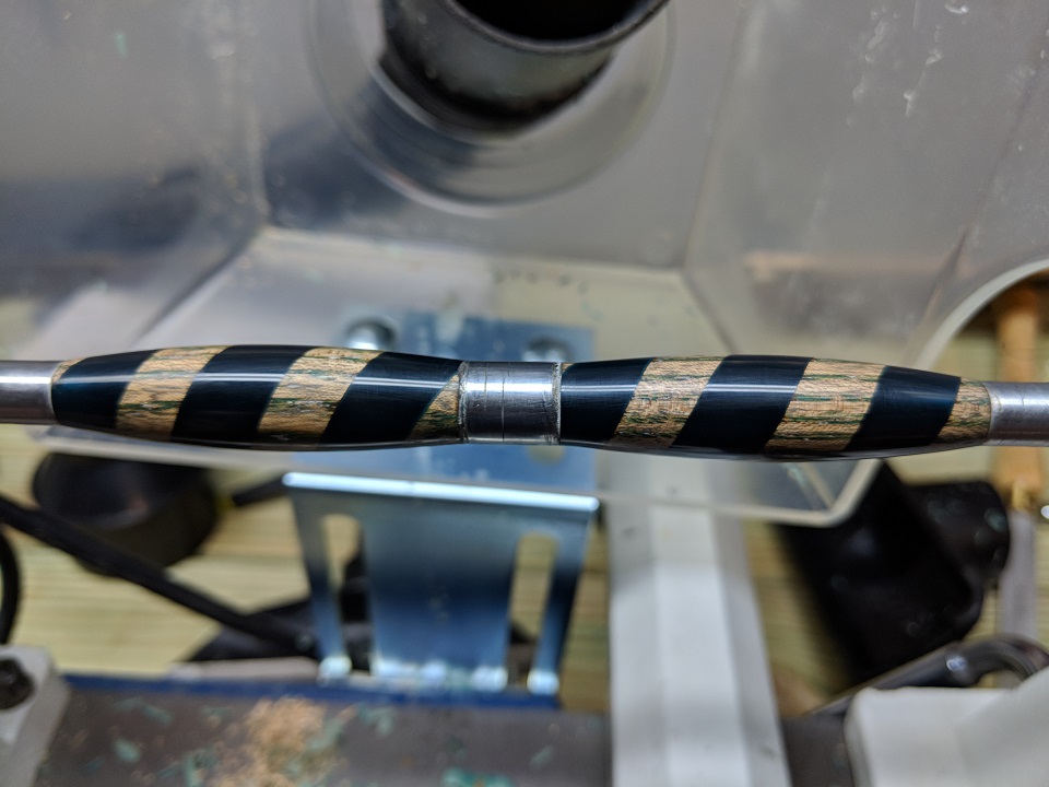

I have a question after looking at the links provided what are we looking at?? Is that a wood with blue acrylic segmented in there?? Is that a spiral design or just biased cut segments?? That will have a different effect on what you can do and what you should do.
Chris the last photo you shown that you said you are getting better is showing me another problem developing and that is contamination of the blue in the wood grain. Is this on purpose?? I am not getting this blank. People are giving you answers to something totally different than what you are showing. We need to take a step back here.

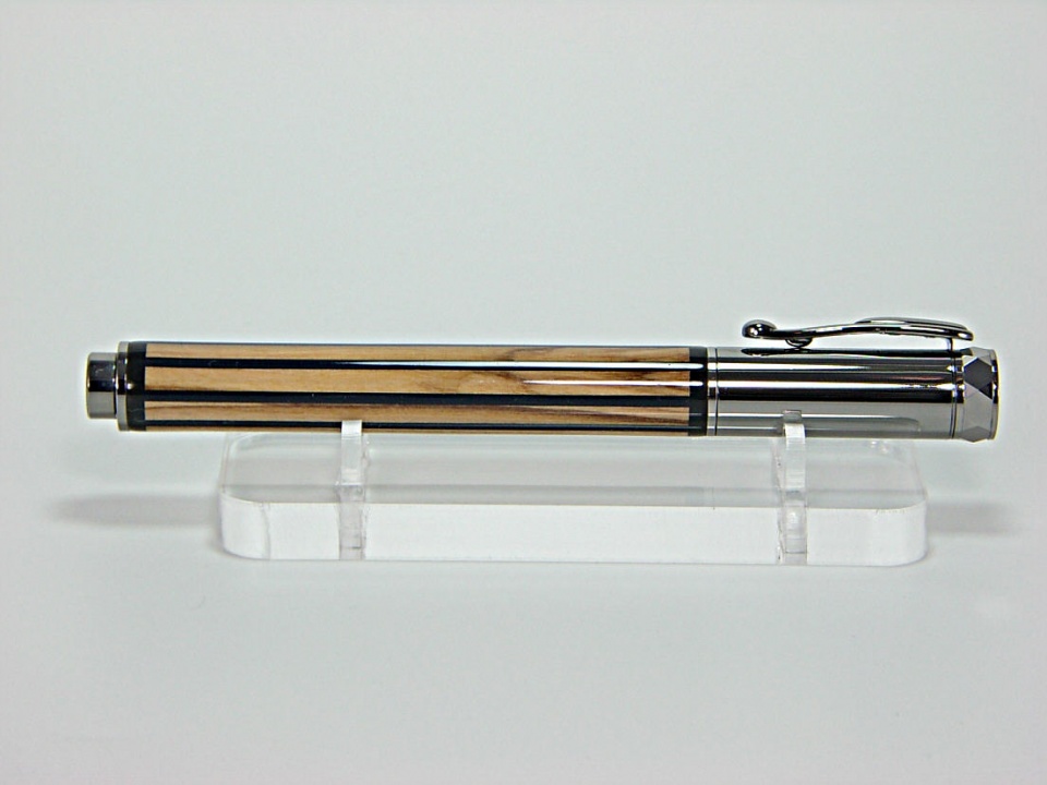

Here is an example of acrylic and wood being used together. No way was I sanding and polishing the acrylic and then sealing and CA the wood and then polish out again.

Howdy,
That is a standard wood pen blank that I drilled the middle of, spiral cut on the lathe and then cut in 2 segments and filled with GREEN resin(lol). The contamination was not intentional but it was more of an experiment so I just decided to finish. It was cast with a slim line tube in mold if that makes a difference.
