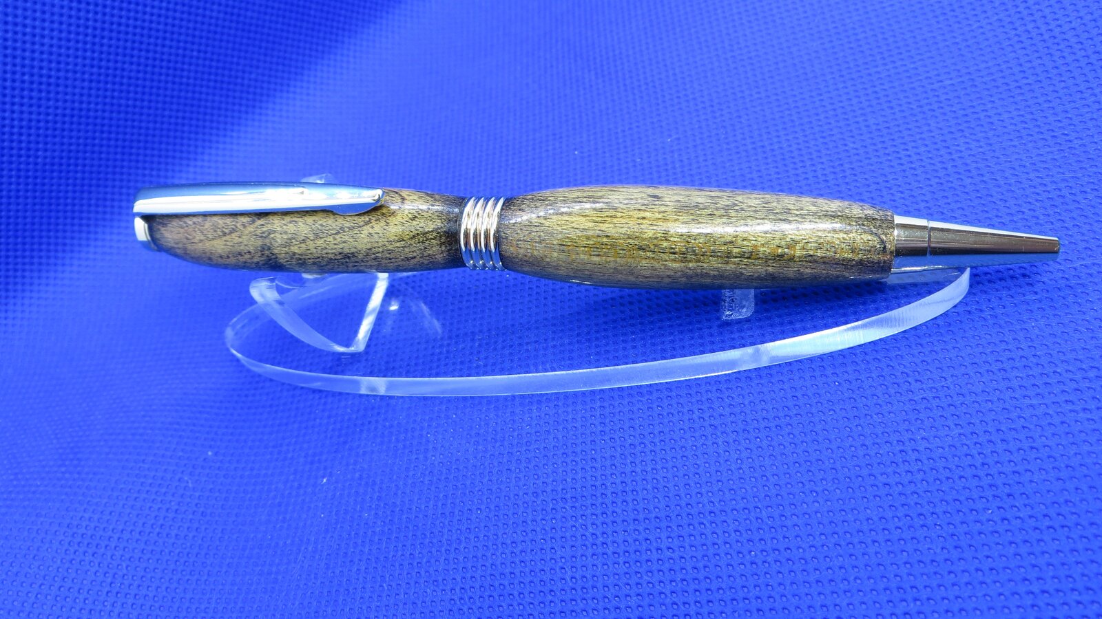

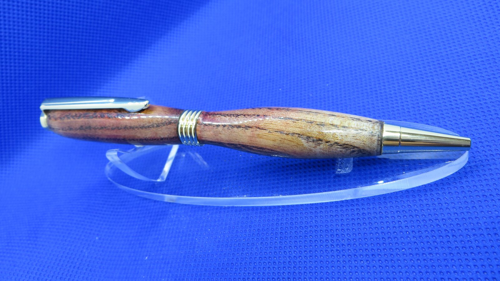

I have been playing with Sprit Stains these are my first attempts. And its not as easy as I thought it maybe. I now realise that you have to sand very carefully and mixing colours needs careful consideration. I have used Cherry and Ash for my first attempt and finished wit CA.
I would appreciate your comments and if you have any tips I would be grateful.
The kits are a cheap Slimline.
Look forward to hearing from anyone who can give me a few pointers,

Absolutely. You did ask for comments and opinions so I posted mine. I maybe alone on this but if you like the look then continue and maybe even try more combos. But look at the ends of the blank and this comes with sanding grit and sanding too much in one area and not enough on the ends. Then the stain gets absorbed differently. But to me the wood is just too plain Jane and not a fan of plain wood on a pen blank. Good luck.

Thank you I now realise sanding is critical. I will give it another go before I give in not sure that CA finish is such a good idea either. Think I will try wax.

The Ash one I can see potential in as it accentuates the contrast due to the open grain. The Cherry one just doesn't work at all for me ( sorry but a personal view) . I have seen Jimmy Clewes and Mick Hanbury use spirit stains then methylated spirit to make them pop on bowls and platters . This is AFTER all the sanding etc has been done, otherwise, as you have found, you differentially sand out the colours. There is no good reason ,I can think of , why this would not work on pens. They finished afterwards with acrylic lacquer to seal the colours in. Do not use cellulose lacquer or you might get a shock.

What was your sanding process before staining? Looks like you may have used to fine a grit and closed up the grain
When staining wood it usually works best to not go beyond 220.
How did you apply the stain? Did you go with the grain when applying? Fast drying dye stains can be tricky when hand applying, cherry is one of the woods prone to being blotchy with this method
Keep on experimenting..

Thanks for your comments I sanded down to 600 and applied the stain with a pad and the Lathe stationary running along the grain.
I have 4 colours Red, Blue, Yellow and Black. I started with Blue and followed Red then Yellow till I got the effect that looked OK.
Followed with CA.
I will try again because I wasn't happy with the result but invited comments.
I think just one coiur would be best because so many causes the effect to become muddy less maybe more effective.
