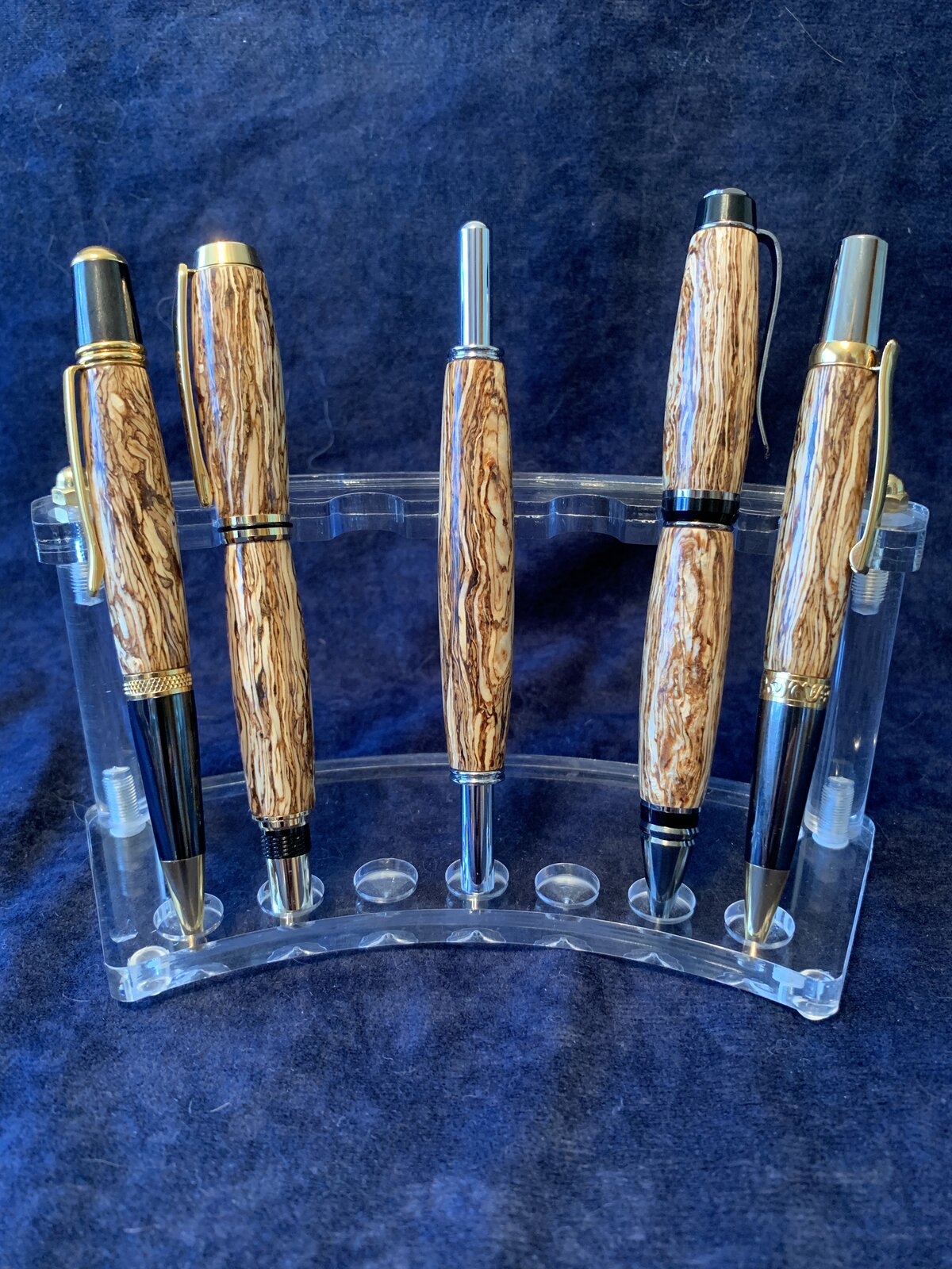

So let me start by saying I have not reverted back to my post high schools days, but I have gotten into Hemp. 😊
Hemp wood that is. I received four pen blank off-cuts so I thought I would play around and see what it looks like in different pen kits.
Left to right is a Sierra (Berea), Navigator (Woodcraft), Seam-ripper (Pen State), Hybrid Cigar (Berea), and a Sierra Elegant (Berea).
Mr Vic
Aug 11, 2008
1,865
Falcon, CO
Almost looks like a Carmel Acrylic. I like them all. Would go good with gunmetal components.

Your spot on! Hemp wood is compressed wood. It's just hemp instead of wood chips.
some folks like the look and others can't stand it.

That makes for some interesting "grain". Is it hard to work with? I would hope the matrix used would make it less chippy than palm? There are some beautiful dyed blanks available out there, too.

I hit the blank with thin CA after drilling. It helps knock down the chippy-ness to close to zero. The pen will still have a bit of a rustic natural feel to it. I good probably get it glass smooth, but it takes a bit more effort.
the one ding I have is cutting and squaring the blank. It produces a really fine dust. Coats everything in site, even with dust collection on.
