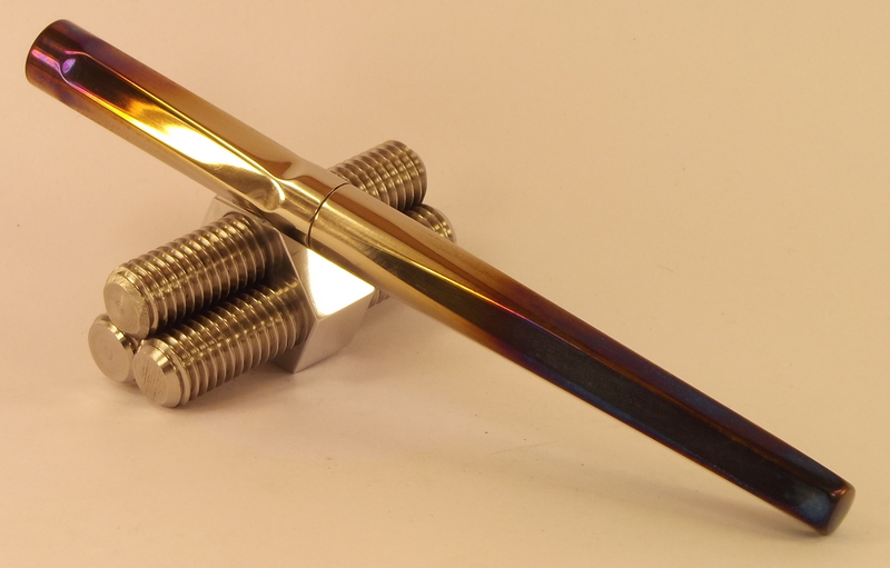

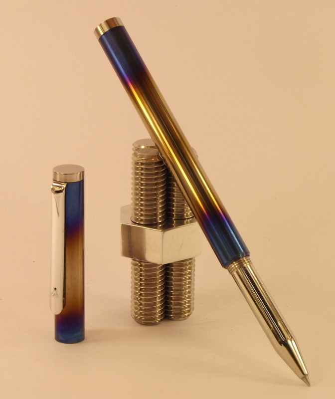

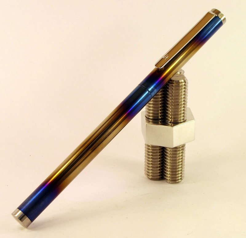

It's been ages since my last pen so I decided that I needed to try something new....... for me, anyway. :biggrin:
Titanium barrels with stainless steel bits. And a chrome slimline clip.
I used a blow torch on the ends to get the colour. For a first attempt, I'm pretty happy with it. It's not flawless but passable. :rolleyes:
Hope you like it too. :biggrin:

Have not made a pen in so long and this is what you come up with. You have not lost your touch sir. Still got that imagination. Missed this. I like it. Wonder if that process could be done with other materials and what the look would be say on aluminum or even stainless or copper.
Thanks guys:wink:
JT, apparently the heat colouring process only works on ferrous metals, so no to aluminium , copper and brass etc.
It does work on stainless but in my very limited experience, it needs more effort and care than titanium.
All the research on the web banged on about cleanliness of the metal.....well, they weren't kidding !!
Here's a practice run I did on an old stainless pen. Not so good, but it worked...
I think I may play around with 'masking' areas and tricks like that. :biggrin:
