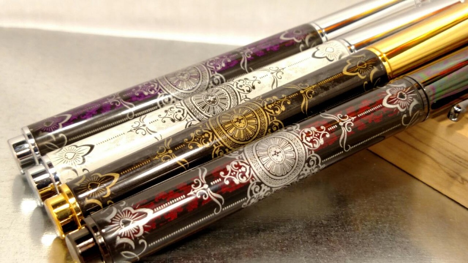

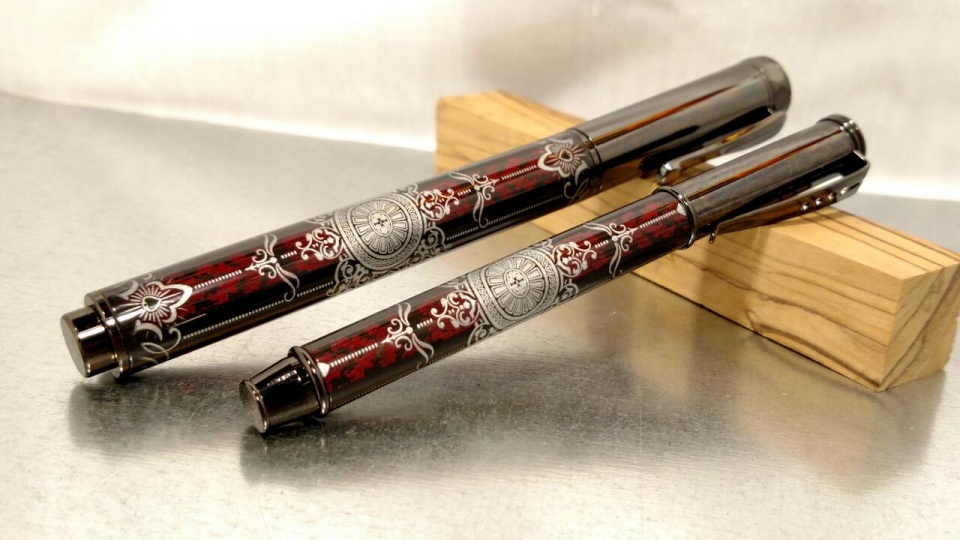

All the information to do them is here, you just need to take the time to put it to practice. I've been doing them for a little over a year now, and yes I do sell them, hence the reason no how to has been posted. There are a few others I know of that have tried them, but have since given up. Really the hardest part is keeping the cards looking good when you delaminate them, and sizing them right.
They're ok.....
Thank you Les!

I was going to suggest the Zen kit because you can use almost the entire length of the card but still need to choose the seam area well. Looks good.
