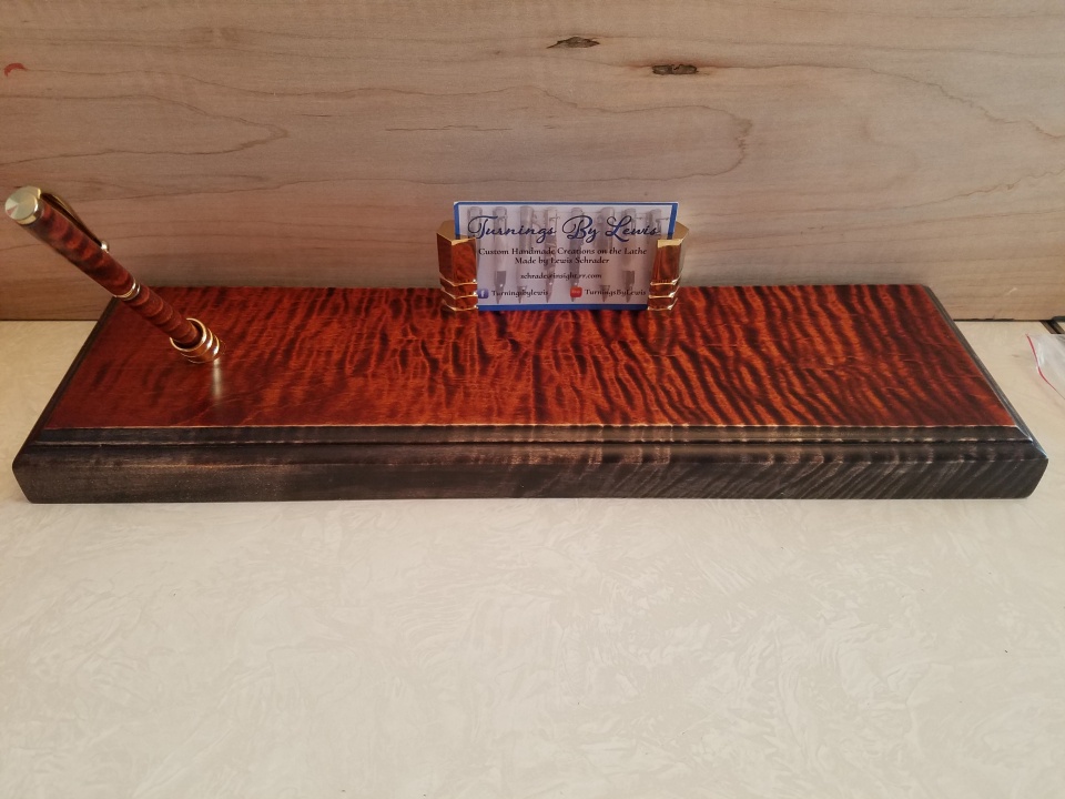

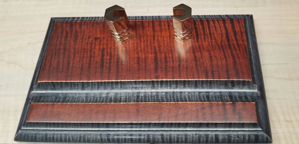

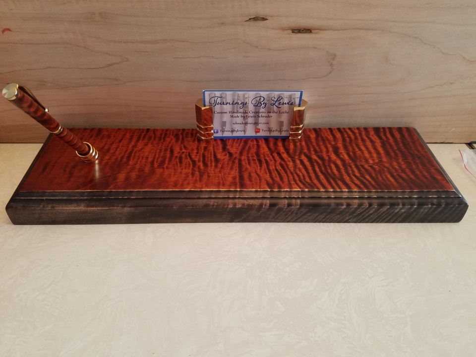

I got some really nice curly maple a while ago and a friend wanted a desk display with matching pen. Came up with the large piece, then he also wanted a smaller piece for a tru-stone pen I made him.
The business card holders aren't fastened down yet an either of the pictures, so they might not be centered, FYI!.
The larger piece is finished in Wipe on Poly and it didn't seal in the color as much as I'd hoped. As a result the sides faded some and accentuated the lack of curl on the left side.
Used Arm-R-Seal for the smaller piece. I like this as a finish instead of the WOP. Seemed to lock in the color better. Better piece of wood also, with curl all over.

Thank you. This one was actually a mistake, as far as routing the pen slot goes! I set stops so the groove wouldn't go end to end but I made a slight mistake. Ended up going end to end to fix it and I like it. I have another one almost done where the groove is "correct" and only 3/4ths the length or so. Booth look good, so I don't know what I prefer!

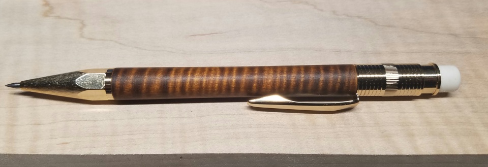

I just used Arm-R-Seal on a curly maple pencil that is a gift for my woodworking "mentor" who lets me use his sanders sometimes and router before I got mine. I think I could have got a little more shine out of it, like I did with the desk display. I think he will enjoy the utilitarian finish though. He uses Arm-R-Seal on a lot of stuff he builds. he's a cabinet maker and all around wood worker.

I know, it looks like there's slight bow in the pen body, but I put a straight edge on it and it's very close to perfect...Only see it in that picture!
