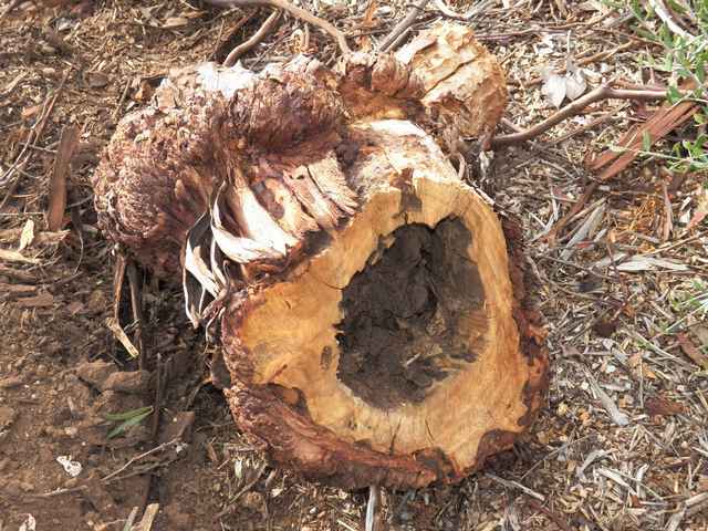

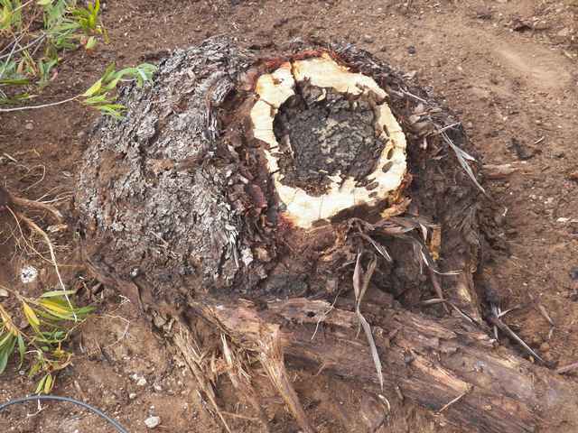

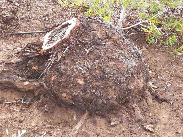

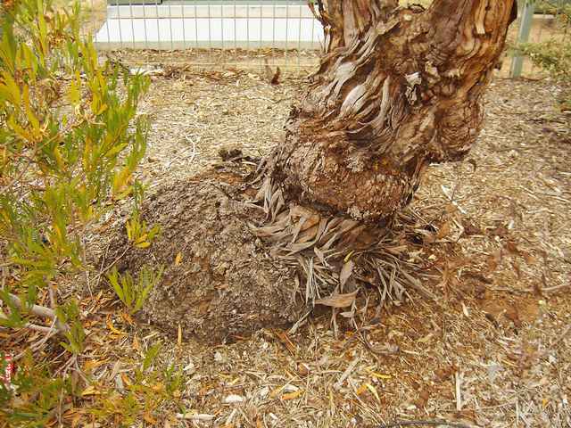

I have been gathering some small jobs, trying to do a couple at the time, saving me time, travelling and dollars so, yesterday I started by removing this medium(ish) Platypus Gum burl that I found inside of of a near by hospital car-park, with the small tree being dead for some time...!
It took me some effort to get the correct permissions to get this burl but, nothing comes to me free hand so, nothing is new there.
A bit of digging in the middle of a damn unexpected storm that soaked us in seconds, before we had time to run for cover but in the end, the weather did allow us to finish the job and get this burl in the trailer.

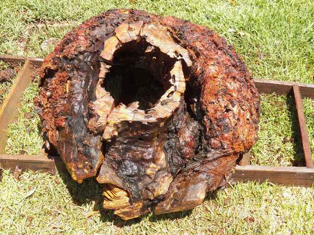

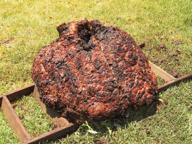

The problem was, the damn thing was hollow (of burl but, full of mud, instead...!:mad:). Chainsaw chains just don't last long of this termite mud so, after 6 chains changes, I got it out, by extremely disappointed...!:frown:
It was a lot of work just to get the OK to get it, and after so many chains buggered, I was expecting a lot better but, the termites have built a nest on and under that burl, was only the hard shell of the burl that kept that small tree from falling over.

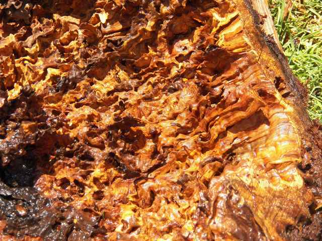

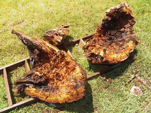

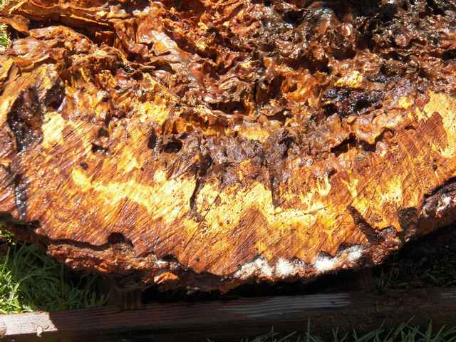

Interestingly, the very same thing that kept that tree standing up, has shown to be of extreme beauty, after I got hole all clean/washed all the mud out. The extremely hard/dense edge of the Platypus burl, of which the termites had to work a lot harder to eat, has created a meticulous "carved" surface on the burl by these termites.
Going a little further, and taking a piece to the bandsaw, has proven to be quite of a pleasant surprise. No amount of washing seemed to stop the bandsaw blade to throw sparks every so often, taking the "life" out of the blade teeth in no time but, I saw how I can make some blanks that will be completed with resin casting where the termite carvings will be the primordial focus, completed with the stunning burl wood attached...!
The 6 long months of waiting to be able to get this burl, still are a bit of a disappointment, as I would prefer if the burl was intact but, considering that I could have done all this worth for absolutely nothing, if the burl was "totally" eaten or, the permission to get it out, have been denied, what I endup with is not as bad as it could be, huh...! modesty sometimes helps in these situations...!:wink::biggrin:
So, is not going to be long before, I have some samples of what I have in mind done, and if they just came out half as good as I have them picture in my head, is going to be OK...!:)

I obviously make the wrong selection of the forum that this thread should have been posted on (market research, in my view...!), even tough I would be limited to 5 pics on the OP which could have been addressed by one or more follow- up posts but, the reason for this second post is to pic your brains out, in regards to your thoughts on uses for this burl cap/shell/edge, what would you make out of it...???
I'm glad that I got involved with the pen turning world some years back, allowing to certainly utilize pieces of wood that otherwise would be very difficult to utilize. Pen blanks, do allow the use of small pieces of wood but particularly, those small pieces that have a lot to go for them.
One other crucial addition to the pen blank making, was the resin casting, complementing perfectly the use of those small woods bits that still didn't make it to the full size or even, pen blanks shorts.
So, give us your thoughts and possibilities for this strange burl shell...!:wink:

It's cool looking stuff, George! Lots of ways you could go with something like that... If you're into carving with an angle grinder, you could get a sizable bowl from one of those shells. Parts of the burl look fairly thick, so hollow forms could be taken from those areas. On the topic of casting, it would be interesting to cut a section say 6x6" and cast the 'termite' surface. After the resin setup, you could cut blanks from the surface... I think that might help preserve as much of the termite work as possible. In fact, if you cast the bug eaten surface of a chunk, you could then turn a hollow form with the resin/bug area near the top of the form... You'd end up with something along the line of the stuff that Alan Trout does. Anyway, that's what pops into my head when I look at those pictures.

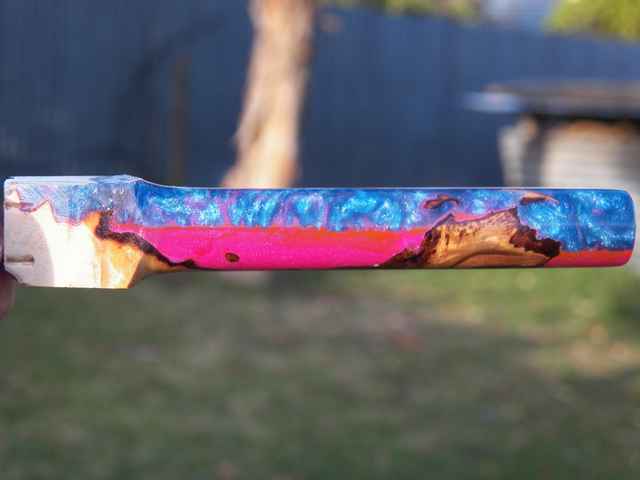

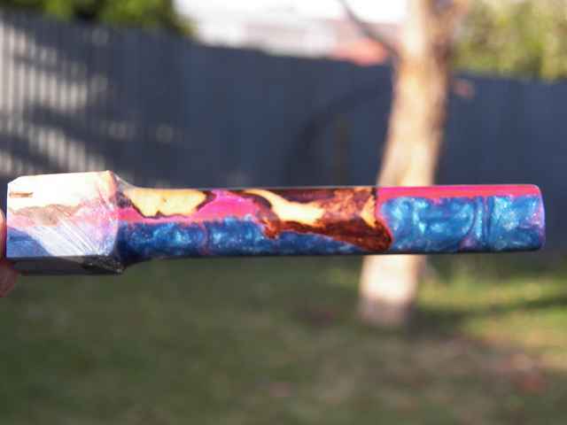

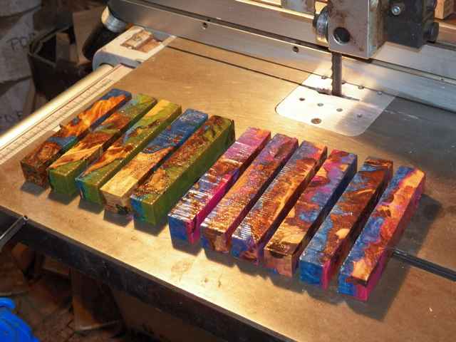

I've got the blanks out of the 2 molds (one 7 the other 6 blanks) and I got the finished this evening with, enough time to turn one of the blue and green(ish) group. Actually, my wife was the one to pic one of each group for me to turn into a sample, her first choice did come up good, will see how the second one will come up...!
I didn't probably use the colours that I would have preferred as I'm out of casting stock and need to re-order another lot ($500.00, or just a little over...!) but the colours are OK, where I always try to give the emphasis to the wood and not the resins filling the spaces, just my way...!:wink::biggrin:
So here are some pics of what I got so far. The pics quality isn't that good as I was in a hurry and I was also running out of natural light...!
Enjoy...!

Yes Cindy, I little bit of work a some imagination can certainly, transform waste into treasures and while these first lot didn't come up terrible, I'm expecting to do better...!
Thanks David, they aren't too bad but, I'm experimenting...!

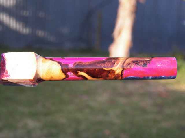

And now, I will attached the second sample pics that I finished today. Again, not happy with the way the pink come out, it became a almost solid colour when I used Pearlex and something else, that something else have spoiled the pearl effect on the colours, damn...!
Oh well, no big deal...!
Cheers
George

We have various species of Termites in Australia, and while a Google search will give you all the information you need, I can simplify it by saying that, there are big and small ones, all most white in colour, some are more "vicious" than others and they all tend to have different wood preferences however, they all are BAD news and causing millions of dollars damage, every year so, they are all nasty.
As for the nests and the way the way the eat wood or leave the left overs, it depend more on the wood than anything else, most trees the sweetest and softest part for them to feed on is the tree's heartwood however, some tree species have a very hard heartwood so, they eat the sapwood.
In the case of this particular burl type, the Platypus Gum has a very dense sapwood and in the burl formation, the 3 or 4" from the outer skin/bark, the wood gets really hard as it has a dyer content than the inside where is a lot softer and juicier. The channels you see on this burl, have taken a lot of time to make and only the adult termites have strong enough teeth to eat through it. Is the way the burl grain is formed that forces the Termites to swerve everywhere to follow the softer parts of the wood, leaving this beautifully carved caves/formations.
For 99% of those dealing with burls, this burl would be rubbish and they wouldn't make any effort to utilise it, as the yield left Vs the trouble of removing it, destroying their chains and any cutting tools they would use on it afterwards, such as the bandsaw, not counting the amount of time and effort to remove most of the soil and nasty stuff that would blunt anything just by looking at it (well, sort off...!:wink:)
