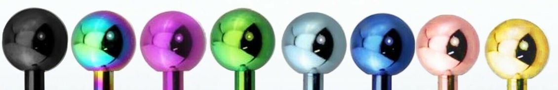

I find it interesting that your source indicates PVD for Titanium Gold and Black Titanium. Titanium is often anodized (a chemical/plating type process) to change it's color and colors run the entire gamut including the multicolored "Oil Slick" appearance (photo below). Compared to sputtering, anodizing is much less expensive and is much more cost effective especially when higher volumes are required.
The company I retired from did both anodizing/plating processes with Palladium, Platinum, and Gold as well as sputtering of Titanium Nitride, Gold and other precious metals. The cost differential and capital requirements between the two processes is huge.
In comparing black for instance, PVD black on Titanium is usually a very dark dark black where anodizing usually produces a lighter black more like a dark or near-black gray color.
Dave

Thanks Dave. That's quite an education.
