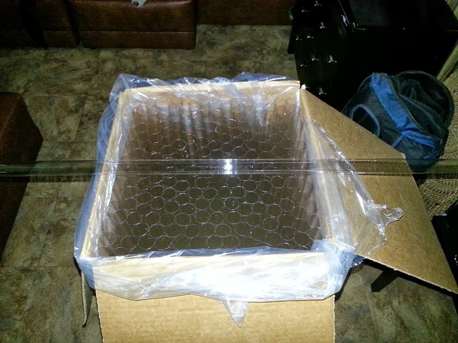

You want tube. I got your tubes. :tongue:
