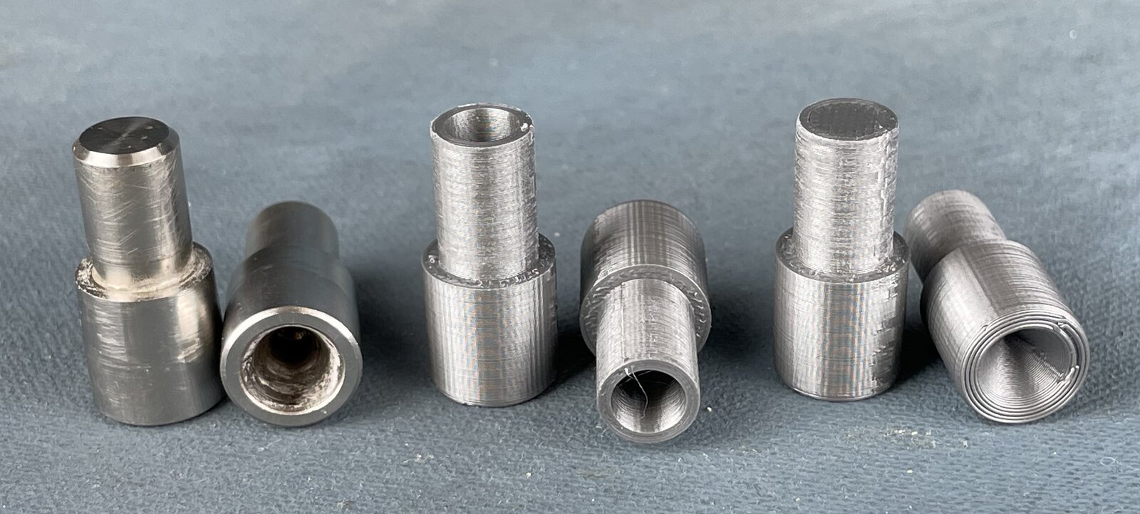

I 3D print bushing for sanding and buffing. I have them for many popular kits.
Would you be willing to share your bushing files? Seems like bushings would be a fine early project for my first 3D printer. Also, what filament are you using, assuming you're not running them on a resin printer?
Yes. Which pens do you make? I have two Prusa MK3S+.
I use pla for most bushings. I've recently started making just the buffing bushings one at a time using PETG. Too stringy to make a whole set at a time.
