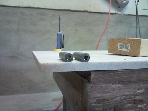

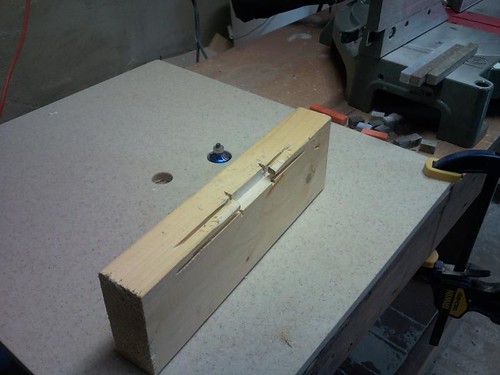

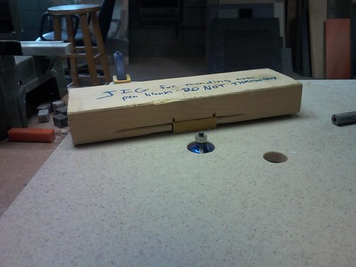

I turn mostly Corian, and made this jig for safely rounding over blanks with my router. I doubt this is anything new to you all, but it does help with the chipping issue.
Have a nice day,
Seth
