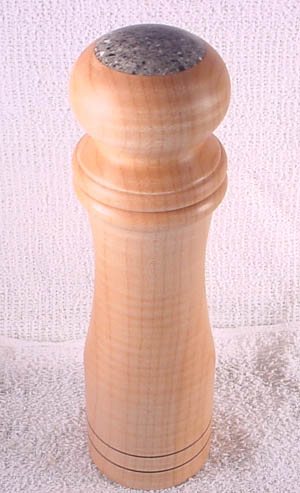

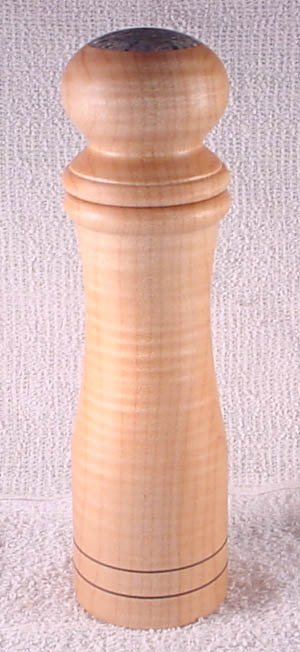

The blank was a little small to do much so this is just a "clean line" mill. I have a salt shaker in the works with white corian inlay. We'll see if I can make two things that look similar.

Can you elaborate on the Corian insert? It looks very clean. Was it just with a forstner bit?? What method did you use to size the Corian? I really like the way it looks up there.
dubdrvrkev
Apr 6, 2005
1,036
Gilbert, AZ, USA.
Thanks!
I took a corian square and put some double back tape on it and taped it directly to the end of the spindle. Then I brought up the tail stock for support and rounded the Corian to 1.5". You need to keep the sides as flat and square as possible to minimize the the glue line. I used a 1.25 forstner and enlarged the hole till the corian had a nice slip fit. I set it in about half the thickness so I could shape the top of it. You'll need to keep that in mind when you make the original recess. Then just epoxy it in and after its dry shape and sand it. Clear as mud?
