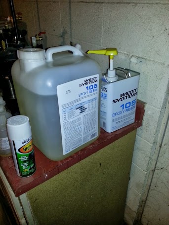

The 105 came in today, the 207 is scheduled for tomorrow.
The can on the right is the empty 1 gallon can. :biggrin:

I like the pump on the gallon can. Did you buy that separate? I hate pouring my PR from a rectangular can.
Yes, they sell the pumps specifically geared for the West Systems. Three pumps come in a pack, 1 for the 105, one for the 207/209 hardener and one for the 206/208 hardener.
You don't need to measure, just 1 pump of 105 gets 1 pump of whichever hardener you are using.
The pump is now on the big jug with an included extended down spout and adapter to make it fit the larger opening. The 207 can will be the same.
The pumps will likely work with PR also, but you'd only need one.

I do use pressure, The blue thread blank that you got was Alumilite which I think had voids because of how fast it sets up or not enough pressure (I cast at 45psi usually). Part if the reason I put in 7 blanks (4 with some voids and three tube in that were void free).
The clear casts I only get a rare bubble with the West Systems since it allows more time for the bubbles to either float or dissolve back into the solution.
You can see the top of one of my pots behind the resin above.
