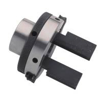

The kit calls for a 6 x 1.5 x 1.5 blank. The only chuck I have is a (shown) drill chuck. What kind of chuck do I need. What is the best all around chuck to have onboard. My only interest is pens but maybe I'll work on a few small projects.

If it is a threaded insert, odds are that it is 3/8 by 16 threaded.
The Ruth Niles mt stopper chuck runs true and works well as a partner to your drilling chuck and live center.

Can I use it safely with a 6" blank. BTW nice system(Niles). New to me and looks like a must have. I'm looking at the Niles Stopper website and don't know where to start. What is the best all round kit. I'm using a Jet 1015. The only accessories I have right now are the PSI blank chuck and 1/2 drill chuck. Thanks

I just sold 2 PSI 4" pizza cutters That chuck works perfect.I used cocobolla on one But still use CA. The threaded insert on the PSI is 1/2" and gets epoxied in Not like the one from Exotic Blanks where you have to tap the handle for the insert.Both makes are Really nice when done.
