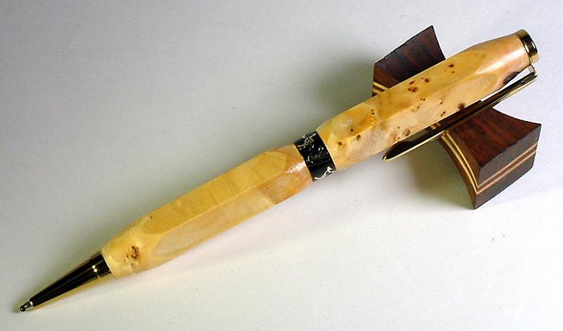

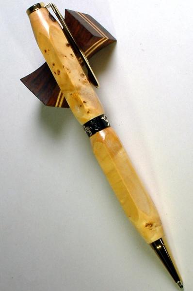

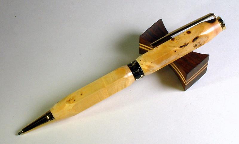

My Pith Pen sent to Qbalizhere Roger Main he received it with 4 blanks on the 5th of this month.
The pen is 2000 yrs old Huon Pine Burl faceted.
Kind Regards Peter.

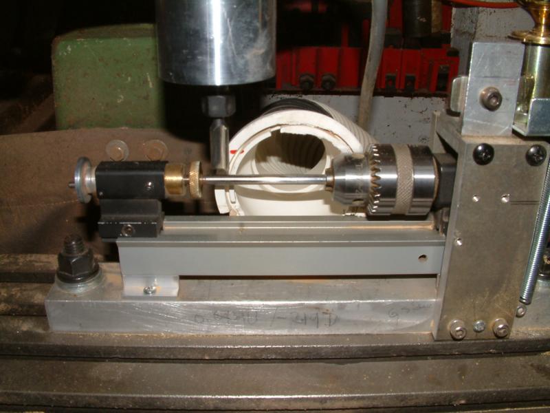

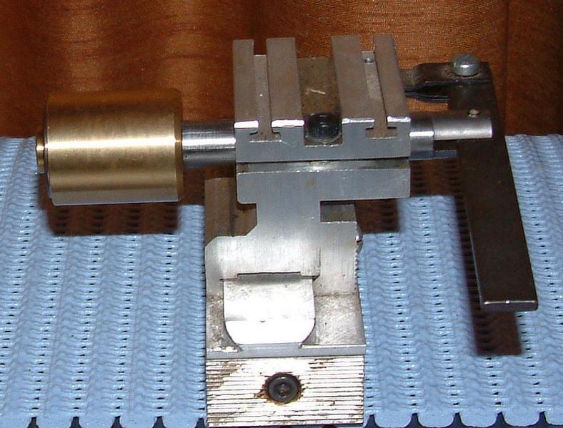

A pic of my simple device I used together with my lathe there was no sanding on the facets.
If you look carefully at the kit it is the made for David Timberbits Fauna Series Ti Streamline kit Made in Taiwan Aussie animals around the centre band.
This Penmill of my design uses a simple metal mini lathe no longer in production fitted with a device to divide the circle using two gears one a 72 toothed gear for indexing and a matching small gear to hold it spring loaded in position, all this under an outrigger holding a finishing Router affixed the the Quill of the Mill Drill. So I have an X Y and up and down movement, some people go to the gymn for exercise I do a workout on my designed Pen Mill
I nest the mandrel in the tail stock about 3/8 of an inch, I detest with a vengence the 60 degree point to mandrel horrible method of supporting a mandrel, even modified my Pen Lathe the same way as well as my Taig lathe, Pen Wizard as well.
Have fun I do. Kind regards Peter.
