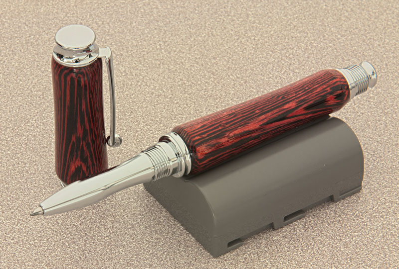

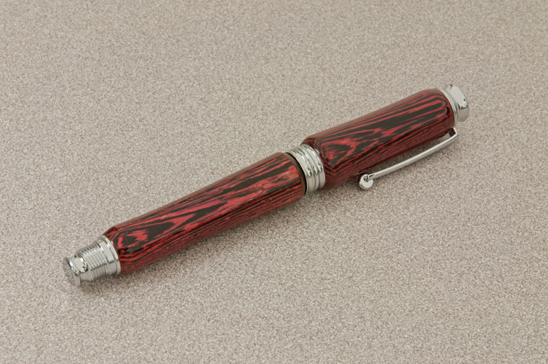

I got a message from Bob ( bobskio2003 ) that he got the PITH pen I sent him, so I figured I would post the quick photos I took before I sent it off... I've been getting pretty lax on taking pen photos lately, but here they go..
The kit is the new Virage Rollerball (technically Woodcrafts re-branding of it as the Metro...). Wood is Wenge which has been bleached, then dyed red. Did a CA finish, but the shaping gave me some trouble and it did not come out nice and glossy shiny like I like, but I didn't want to risk sanding through it and having to start all over again, as that can also affect the dying since the color does not soak in the wood too far.

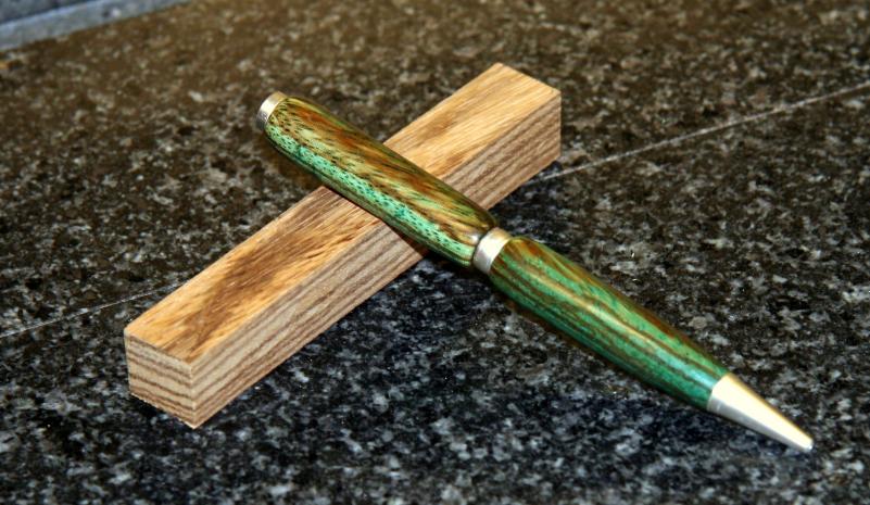

Very nice pen. Interesting idea with the bleach. Could you bleach it any color or does it need to be fairly close to the original color of the wood? Could you do a green color, for example?
You can dye it back any color you want. The lighter of the browns in the original Wenge turns nearly completely white, while the darker brown hardly changes at all... You could do any color your heart desires, I figured red would be dramatic and obvious...
Here is a zebrawood I dyed green
