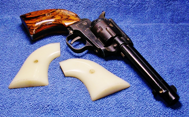

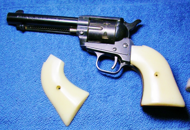

Pistol grips are fun to do and can make a great change in the looks of your gun. Not to mention that they will be a one of a kind that no one else has. Keep the progress and photos comming. Here are a couple photos of a 22 that I made grips for out of Bocote, along with the original plastic grips. No show piece, but a hugh change in looks. Jim S
