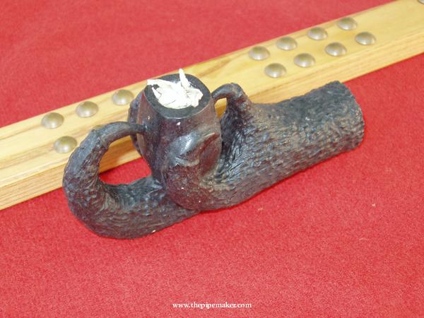

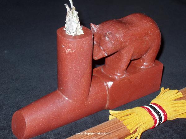

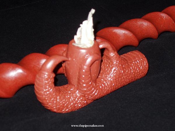

pipestone
Check out "Pipestone" on google search the Indians made pipes out of Pipestone they say easy to turn easy to purchase I have a hunk of it but have not try yet. They say softer than tru-stone about as hard as a finger nail. Pipestone is from Pipestone MN. Easy to drill through.:)
