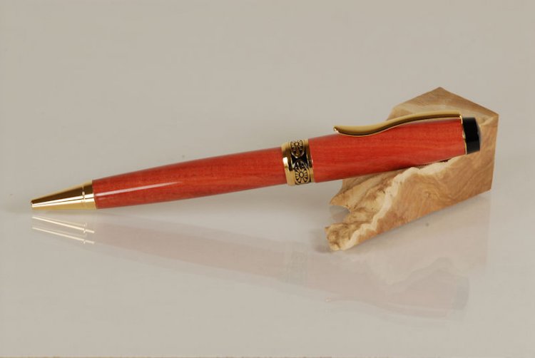

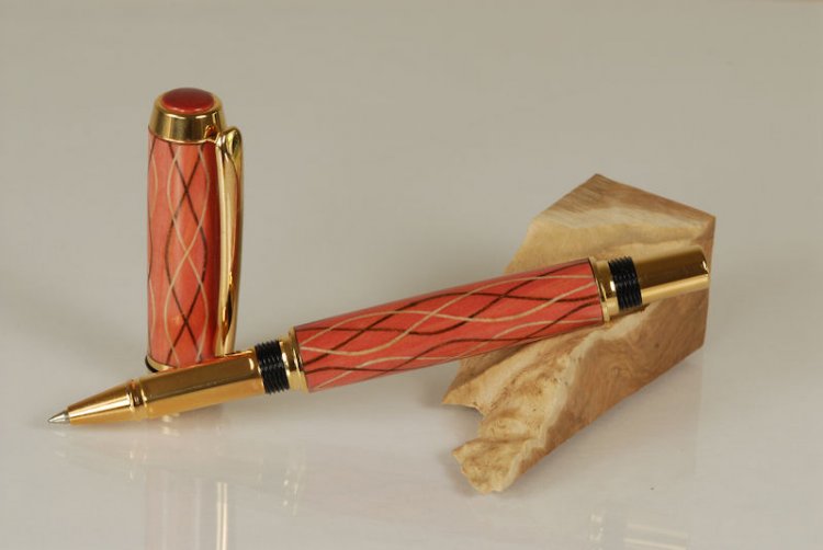

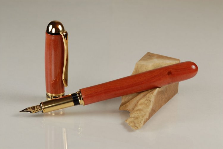

Dennis, as Lou mentioned I do have Pink Ivory available on my site at http://www.zambeziexotics.com
I've made a couple pens from it. I haven't experienced any issues with cracking.
If I can help in any way let me know.

WOW. That's a very nice pen & that is REAL pink Ivory. DJ, you might consider getting some from Keith. Nice lookin stuff. Just be careful, as on most woods, not to heat it too much while sanding/finishing. If you use a friction polish you need some heat, but let it cool off between coats.
