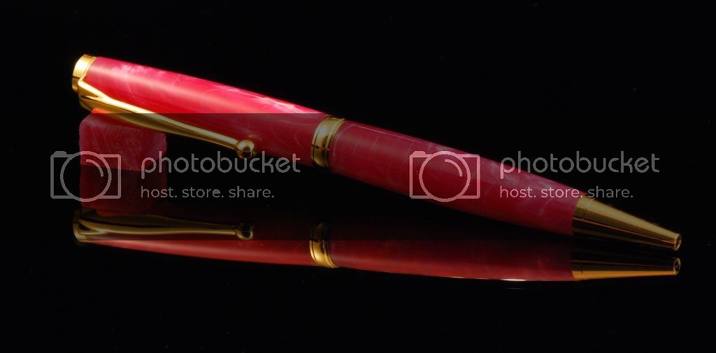

My wife requested a pen for the woman who does her nails and I gave her the catalog to pick a blank. She selected the comfort kit in gold and an inlace acrylester blank that I purchased, but worried a bit. I had heard stories that this material might be above my skill level (beginner). The blank arrived with a set of cautions when cutting, drilling and turning and this added to my worry. I guess it can be done and I really like the material after finishing the pen. The depth is more than can be shown in my photograph.
I will buy more of the material in the future, but stay careful with it.
Yep, it can be a real pain to work with, but most pittfalls can be avoided by s l o w i n g waaaaaayyyyy down.:biggrin: In my opinion the depth can you get from these blanks is hard to beat.
Pen looks great by the way. I turned one very similar for my wife to give to her boss.

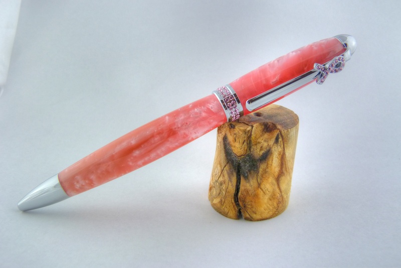

Here's a breast cancer awareness pen I completed recently that shows the depth a little better. It's the same Acylester blank you used I believe. Very chippy if you cut too fast. But well worth it when it works. It looks like you can a few feet down into the blank.
That's a good looking pen - nicely done.
I also have to ask how you get the mirror reflection in the photo with a black background. Great picture also.
