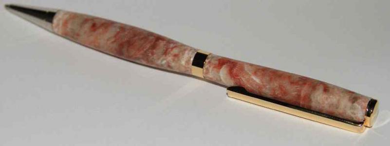

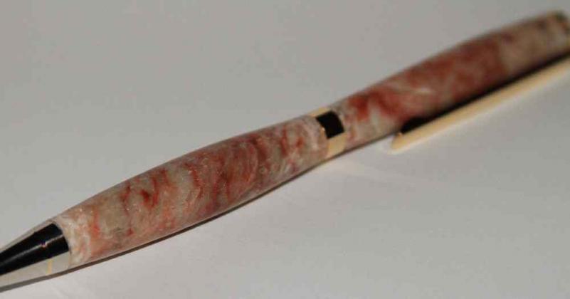

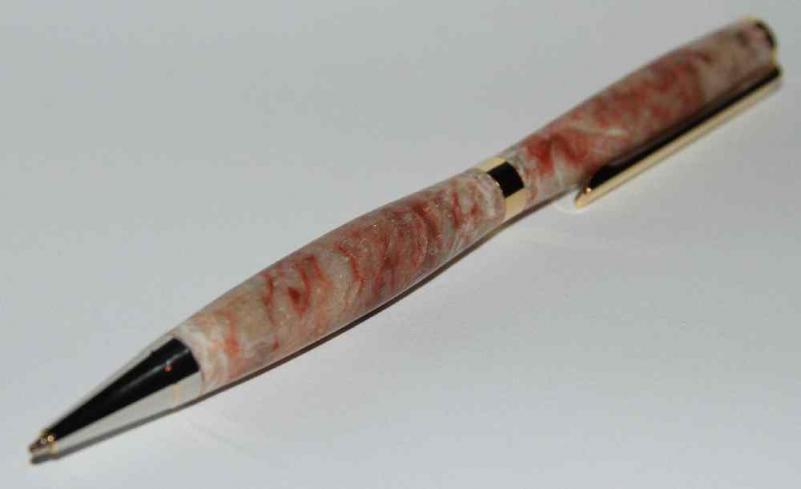

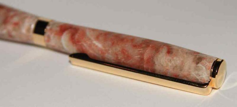

Here are a few pics of my recent pens. I'm new to the forums and hope I am attaching the pics correctly.
When I purchased the stone, it was labeled as Soap Stone, however after working with it, I'm fairly certain it's actually alabaster. There was certainly a learning curve. It's very brittle and not forgiving like wood. Especially when pressing the pen parts together. I had to be very careful not to over pressure the parts.
So far I've made 3 successful pens and confident I can make more now that I understand the material much better.
These are finished to a polish. The first attempt I tried a CA glue finish, but the stone is not porous. The CA glue actually flaked off when I was doing the final polish. The stone itself has a beautiful gloss. I've read a few places to use a bit of paste wax, but even a touch of wax seemed to make it look dull, besides, as I mentioned, the stone isn't porous, so there's not much for anything to stick to.
Enjoy,
-Lee
SE Michigan

Lee, if you can make a stone slim, you can make any pen. Nice work!
I learned a trick from CaptG, and others, sand the inside of the tubes until the parts slide in, then epoxy the parts into the tubes (only put the epoxy on the female side of the joints). That way you eliminate the pressure that is caused by press fitting the parts in.
