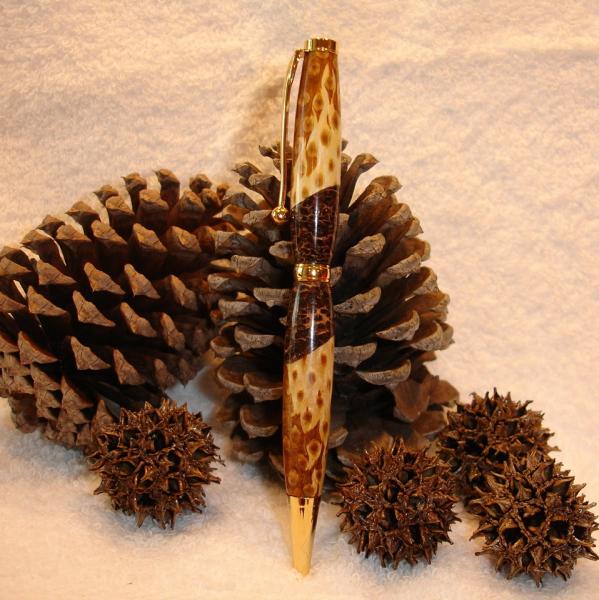

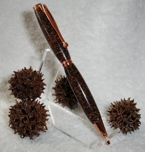

My first post, and one of my favorite designs. I don't cast the pine cones or seed pods. Just turn them, and stablize with CA before they explode. Finish with CA/BLO. I hope you like.

Good for you. That is how I do it, the old fashion way. Try it with a Coulter Pine or a California Sugar Pine. Your work and patience paid off. Keep it up.
Cool!!! I like that you turned into what I call 'The Flame' in the cone. I've got a pile of cones and pods that I need to cast in acrylic, but 'work' keeps getting in the way.
Nice segmenting too! Was that the 'plan' or were the cones too short to cover the entire tube? Either way.....well done!!!!!
Scott (need me some not-work) B
Thanks for the compliments, it really means a lot coming from your peers. Yes, it is a bit tricky to turn, but if you treat it like a really punky piece of wood and are careful (and have the CA ready), they turn out nice. Yes, SBD777 it was "kinda" planned. You have to turn so many cones to just find the few that are good enough to put tubes in (90% don't make it), that I had to find a way to make the "almost big enough" cores work. My wife actually likes the combo better than the cone alone.

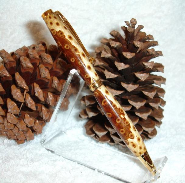

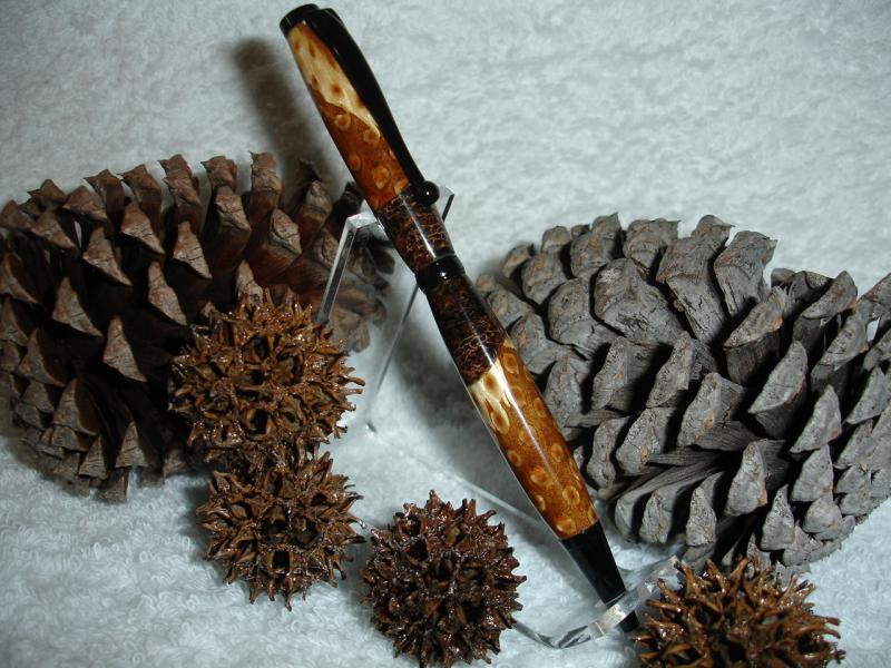

Here's a couple pics of a cone only pen, and sweet gum seed only pen

I'd really like to see custom centerband of larger diameter here on this blank, or may be strimline or comfort (without rubber thing) kits, as they have bigger diameter CB. I do not like not-straight slimlines with kit CB, anyway there's "slim" and "line" words in that name:) It's only my opinion, as a bit advanced beginner:)
blank design is really cool here!
