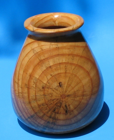

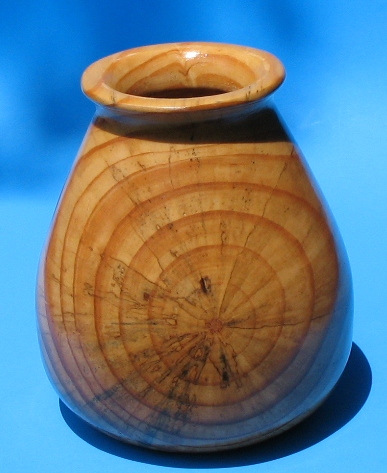

Have a lot of Long Leaf Pine and assume you have a lot there in TX too. Stuff have been turning really messes up everything lathe, facemask, tools & walls but looses the smell. This LLP Vase finished with shellac.
