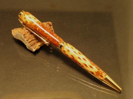

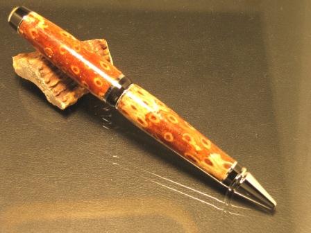

Paul, It depends on the pine cone you are going to use. I use the long leaf pine cones which are very large. I don`t cast them at all. I simply cut the cone down to the core, ,drill,cut to length, insert tube, soak with CA and turn. I will soak once or twice during the turning process what ever is needed. I don`t have photos of the process but this is the finished product.
Texas ought to have the Long Leaf Pines to get the cones from. Hope this helps.
